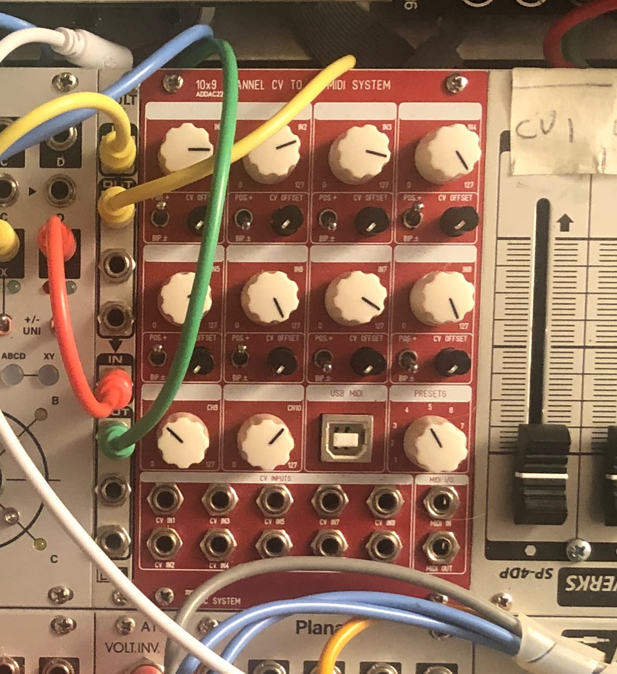

ADDAC221 CV to MIDI CC converter works perfectly. Without anything plugged into it it gives you 10 more knobs. With CVs plugged into it, it gives you 10 CV controllers. I am using mine with 4 Planar2 and one Flight of Harmony Choices and it has worked flawlessly so far. I plug directly from the front panel USB-B jack to the MM’s USB jack.

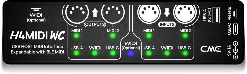

Hiho,
this might read like a commercial but I´m totally flashed by
the H4MIDI WC (sounds funny). 4x DIN, USB device/host and the
ability to power the box via 9V for more beefy USB devices at its host port.
https://www.cme-pro.com/h4midi-wc-usb-host-midi-interface/
Someone made a short summary
https://www.youtube.com/watch?v=LA_7KC_p-zc
You can configure whatever routing and filtering you want via the
configuration software.
https://www.cme-pro.com/start-guide-for-uxmidi-tools-software-by-cme/
