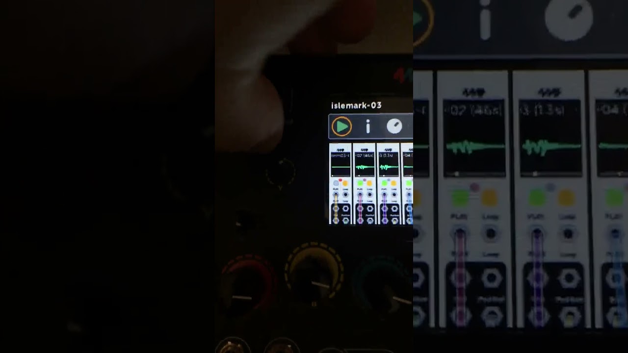

thank you! just now starting to play through all the live set ymls on both mm’s at the same time (typically i’ll play odd number ymls on the left mm and evens on the right mm, but for this test, going through them all on both) and so far no crashes.
but i ran into the following issues playing through: when i got to patch 10 on the right mm, the patch played fine for a few minutes, and then suddenly all tsps started buffer underunning at the exact same time, i noticed the little occasional flashes of red on the button play sporadically happening, and the underrun message was popping up at the top too. when i hit stop on one of the tsps, then the remaining 5 tsps suddenly started behaving ok again. if i turn the one i turned off back on, they all start freaking out again (i all noticed this problem happening occasionally before via previous tsp firmwares)
so i then loaded/ran yml 11 on both mm’s. the same issue happened after a minute on the right mm whereas the left mm played patch 11 100% ok.
then on the right mm, i decided to load 01 again just to see if the problem was going to keep happening (even though i’d already played 01, without this problem) and here’s what happened:
it seems the 1st and 4th tsp’s are both really glitching out hard, but between the glitches i can here that they are both playing the wav file that’s loaded into tsp 4. on the left mm, i loaded patch 01, but this problem is not there. you can here on the left mm tsp1, that the sound should be a pad. so this bug may be related to the one i posted about earlier where it seemed that 2 tsps are both trying to pull from the same buffer somehow?
after recording that video, i played yml 12 and the problem seemed to vanish on the right mm. then i tried playing yml 01 again and the problem was not there. i then tried yml 10 and 11 again, the ones i also had problems with, and the ‘all tsps glitching out simultaneously’ problem was not there. so it seems the tsps/mm gets into a weird state but not permanently until reboot.
note: i did not reboot the mm’s once during this whole test

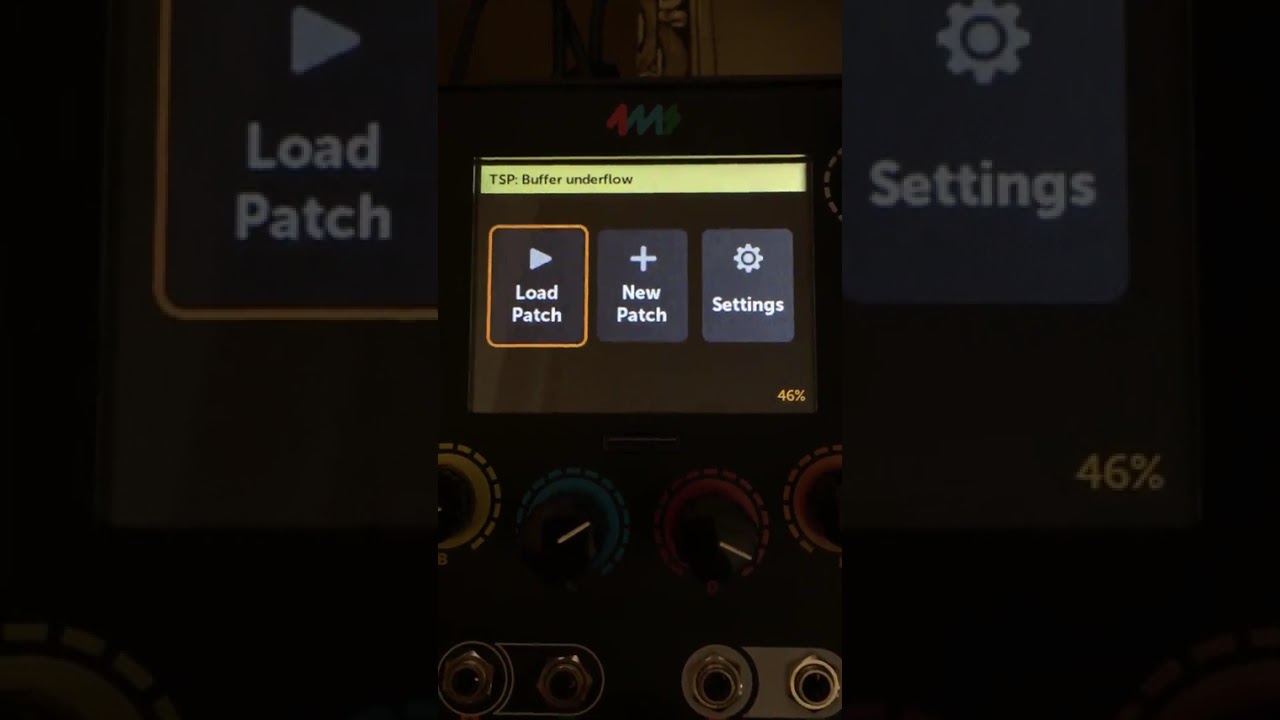

@danngreen - a new issue (tsp-09 firm), saw it happen once yesterday, and then again today. the first tsp gets stuck. the play light stays grey and the read light stays red. all tsps seem to be glitching out until i turn off the 2nd one. not sure if this is related to the weird issue i mentioned most recently above but thought i’d mention regardless:
also right after that happened, i noticed the gui became unusually sluggish. then i loaded the yml after it in the series (04), and the tsp buffer underflow message at the top had become stuck:

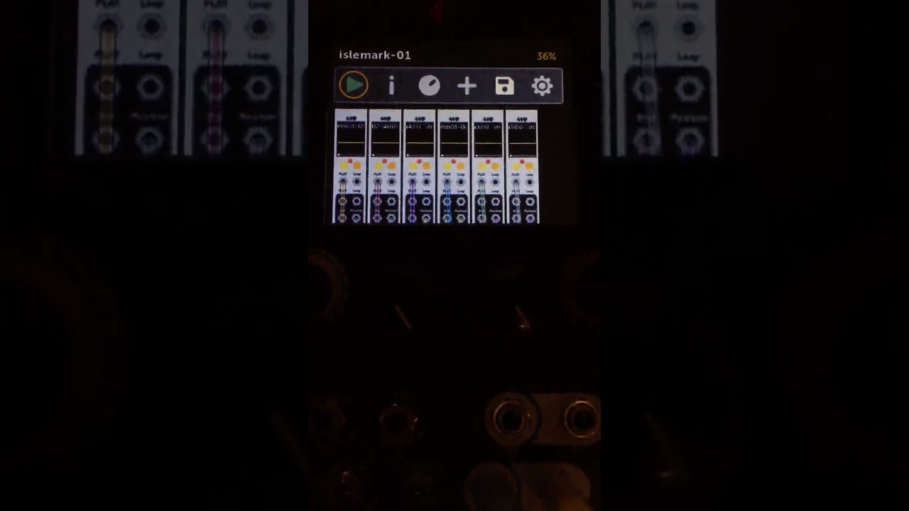

im actually often noticing that the gui is quite sluggish with 6 playing, even though the cpu only shows 44-46%. and the sluggishness (and often the full on glitch outs) typically starts to occur after all 6 have been playing for a few minutes. if i turn any one of the tsps off, the gui starts behaving normally again. this sluggish gui behavior will occur even when there aren’t buffer underruns. and will go away if i revert the patch or load a new yml.
i’ll try and get you a pm w a .rar of the .wavs/ymls here in a bit
also: my system is set to 48/512 (all wavs 48/16), not sure if any of that makes a difference. ive tried turning draw screens off but still same issues. if there are any other settings i should try let me know

I found that happening, and it was because the SD Card stopped responding. The continually retrying was causing the GUI to get sluggish. I fixed that in TSP-10 by resetting the SD peripheral if it fails to respond:
With this version I can pull out the card while samples are playing, and then re-insert the card later and they’ll play fine when I press play (but I don’t recommend doing so! It just illustrates that the TSP is more resilient to SD card read errors).
Also the whole waveform turns red when there’s a disk or file error. It turns yellow if it’s buffering (so not necessarily a disk error but just that we’re trying to stream more than the card can supply)
