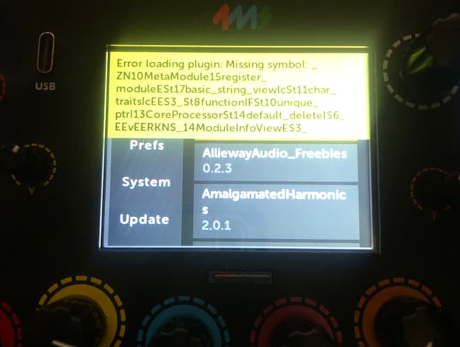

also fyi, certain plugins aren’t loading, getting errors on boot up. so far have only seen this with fundamental and airwindows
Also 4ms XOXDrums, yeah I saw that too…
That was the issue with TSP-13, which I fixed in TSP-14. Or.. I thought I fixed… Hold on, TSP-15 incoming…
OK, TSP-15 Release Firmware Version: firmware-v2.1.0rc1-TSP-15 · 4ms/metamodule · GitHub
alright seems to be working ok now! both plugin errors gone, and sample refs working.
