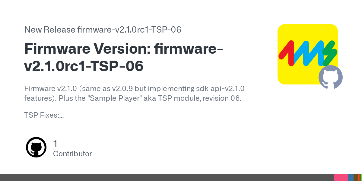

Here’s the fixed version:
https://github.com/4ms/metamodule/releases/download/firmware-v2.0.9-TSP05/metamodule-firmware-v2.0.9-TSP05-firmware-assets.zip
Here’s an updated firmware with the TSP included. I fixed a bunch of issues with retriggering (or stopping and re-starting) that now handles a variety of situations.
I’m working on sdk api-v2.1 which has some new features for plugin devs, so that’s why the version is bumped up here…

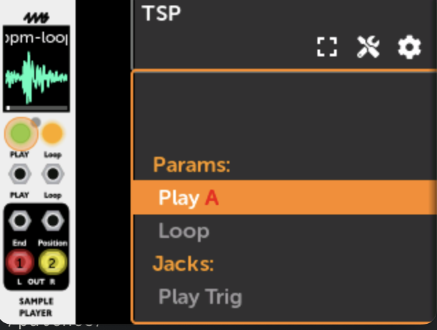

having used this tsp for quite a bit now, it’s really nice and fun for doing basic dj sets (where beat matching isn’t really needed) or having just a few looping stems going! ty for moving the load sample option to the bottom, that really helps speed things up!
however, even with buff thresh at 80% on all instances, im still noticing occasional dropouts when one .wav is playing and going to load a new wav in a second instance of tsp. and ive experienced some underruns occasionally occurring if more than 4 instances of tsp (but not accesing the menus or file browser, the drop outs just happened randomly).
@danngreen just curious if there might be possibility down the road for an even larger buffer option to prevent any possible underruns? i personally couldn’t care if the latency after triggering play is quite high so long as the audio doesn’t drop out at all on stage. or i guess other than that, i’m curious: are there still update/additions planned to the disc streaming code to allow it to become even more stable?
also i’m curious if there might be a way that, if a .wav is loaded into the tsp, when you go to load a new one (in that same instance of tsp), if the current .wav could be already selected in the file browser? that could make doing sets where you need to quickly select the next .wav file down (in the case of dj sets) go much smoother imo.

Yes, in the last version I refactored the buffer so it can change size. I’m working on adding that. Especially in the VCV version, there’s no need to stream, so setting that buffer to a large size would be ideal.
Sure, no problem (that was supposed to be what was happening, but I didn’t finish it until just now).
