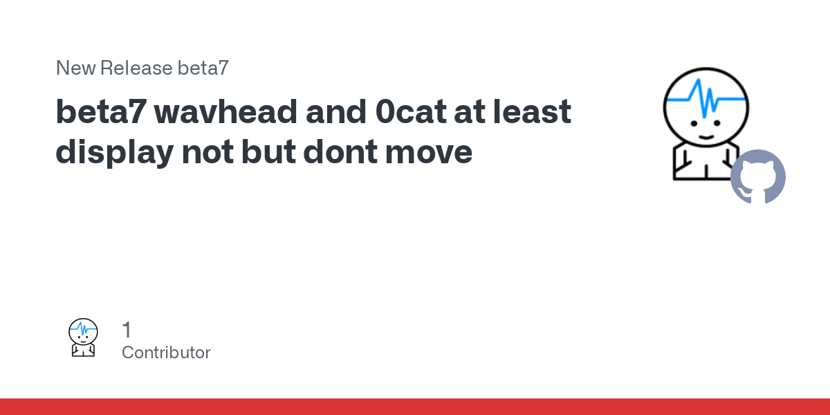

ok so those at least look better, thanks!

Nice, BTW Iâm testing these on -dev-13 just to make sureâŚ

I can confirm that wavhead and 0cat now display correctly in dev-12.14.

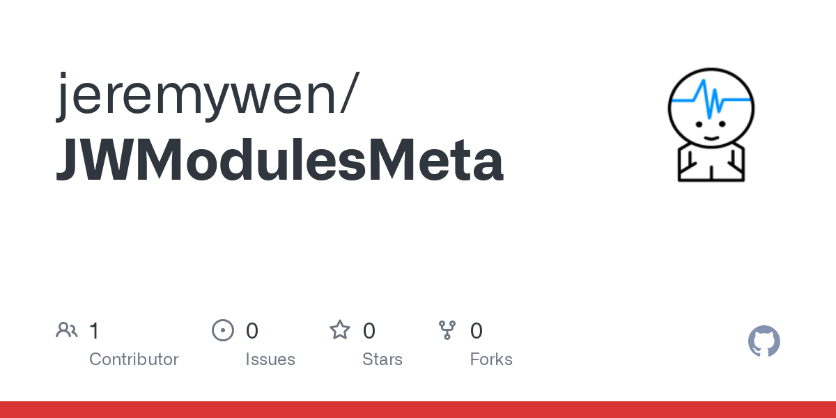

ok I just renamed the latest build to JWModules-v1.0.0-dev-12.mmplugin
and uploaded it here:

That name is not being found by MM. I changed it to JWModules-v2.0.0-dev-12.mmplugin and now it works. It needs to have the 2.0.0-dev-12 in there to be recognized AFAICT. Perhaps @danngreen can clarify.

I changed the release. thanks @tony10000 !
