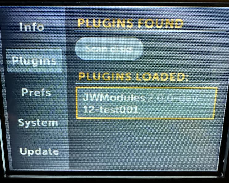

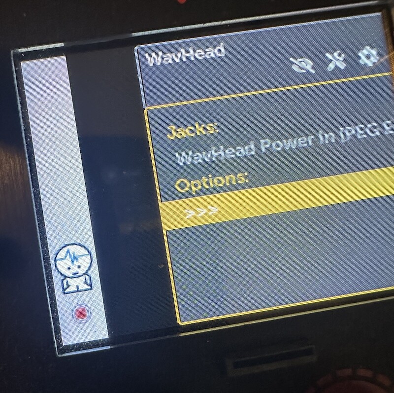

@tony10000 Can you try that plugin he posted?
I’ve had issues unloading a plugin and reloading it. Let’s rule that out, see if you get it to work by loading the plugin immediately after a reboot.

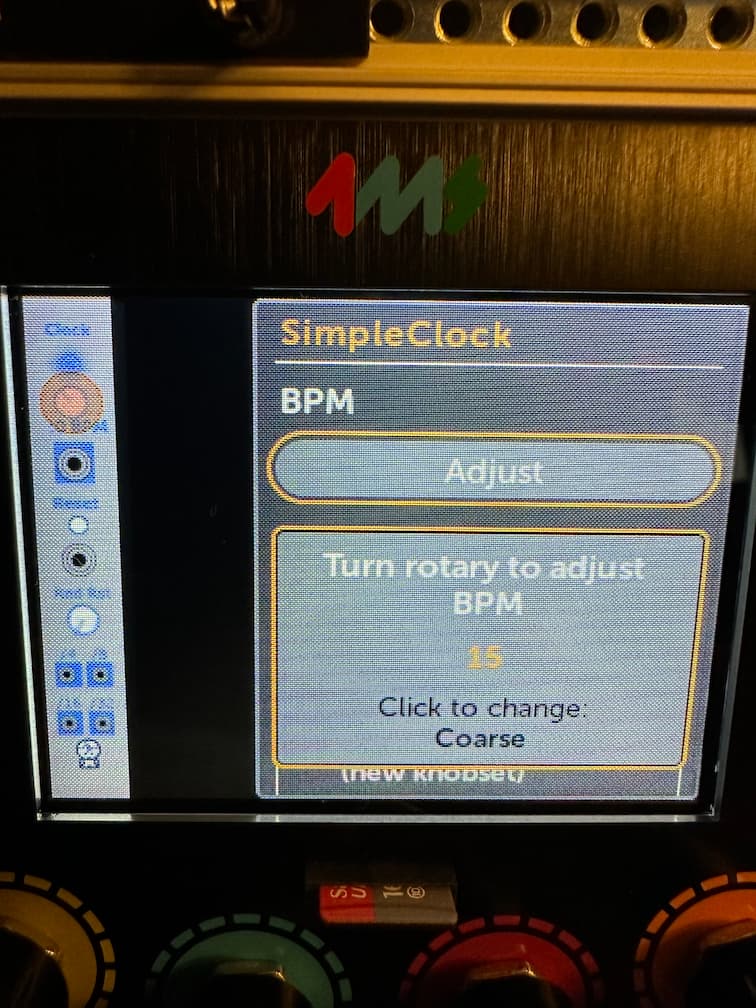

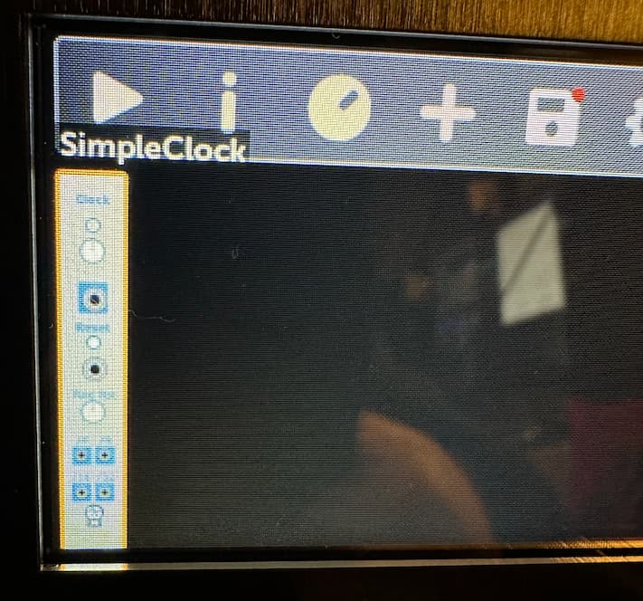

I did not have any freezing on this fresh attempt to load SimpleClock. I set it to 15 and I still see a zero as the last digit. It never updates for me. After leaving the ‘Adjust’ knob screen the text below the know goes away.

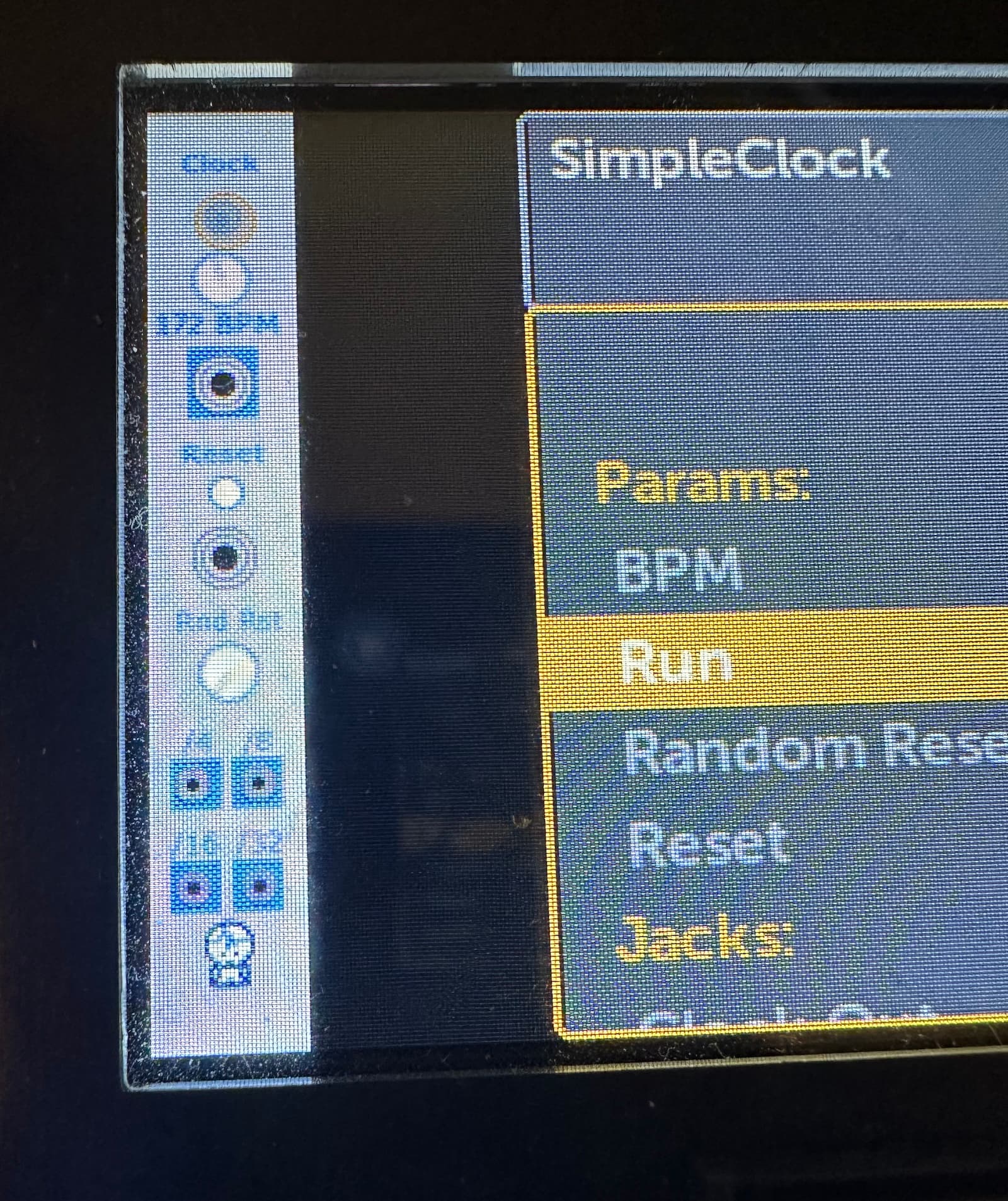

Oh! The patch has to be playing for the text to update (green Play arrow).
:man_facepalming:
omg
i am a big dummy
Ah… no worries. The dev firmware is rapidly changing and has a lot of rough edges – not everything is obvious!
I’m just glad that was it!
Sorry to take up your time like that. I am a noob to the MetaModule. Now l can continue fixing those labels and text positioning. Another question is about FullScope, ThingThing, and Tree. They all use my BGPanel which is just a widget with a filled rect. The MetaModule says ‘Could not load faceplace image’ because it doesn’t have an asset I believe. Should I just make a blank png to make the MetaModule happy?

/Applications/Xcode.app/Contents/Developer/Toolchains/XcodeDefault.xctoolchain/usr/bin/cc -DMALLOC_PROVIDED -I/Users/jeremy/vcv/metamodule-plugin-sdk/metamodule-plugin-libc/newlib/libm/common -I/Users/jeremy/vcv/metamodule-plugin-sdk/metamodule-plugin-libc/newlib/libc/string -I/Users/jeremy/vcv/metamodule-plugin-sdk/metamodule-plugin-libc/include -arch arm64 -isysroot /Applications/Xcode.app/Contents/Developer/Platforms/MacOSX.platform/Developer/SDKs/MacOSX15.1.sdk -mmacosx-version-min=14.7 -Wno-sign-compare -Wno-maybe-uninitialized -Wno-stringop-truncation -Wno-unused-but-set-variable -Wno-unused-variable -Wno-uninitialized -Wno-unused-function -Wno-unused-label -Wno-prio-ctor-dtor -Wno-pointer-sign -Wno-discarded-qualifiers -I/Users/jeremy/vcv/metamodule-plugin-sdk/metamodule-plugin-libc/include -fbuiltin -fno-math-errno -fvisibility=hidden -MD -MT metamodule-plugin-libc/CMakeFiles/metamodule-plugin-libc.dir/newlib/libm/math/k_cos.c.o -MF metamodule-plugin-libc/CMakeFiles/metamodule-plugin-libc.dir/newlib/libm/math/k_cos.c.o.d -o metamodule-plugin-libc/CMakeFiles/metamodule-plugin-libc.dir/newlib/libm/math/k_cos.c.o -c /Users/jeremy/vcv/metamodule-plugin-sdk/metamodule-plugin-libc/newlib/libm/math/k_cos.c
warning: unknown warning option '-Wno-maybe-uninitialized'; did you mean '-Wno-uninitialized'? [-Wunknown-warning-option]
warning: unknown warning option '-Wno-stringop-truncation'; did you mean '-Wno-string-concatenation'? [-Wunknown-warning-option]
warning: unknown warning option '-Wno-prio-ctor-dtor'; did you mean '-Wno-reorder-ctor'? [-Wunknown-warning-option]
warning: unknown warning option '-Wno-discarded-qualifiers'; did you mean '-Wno-ignored-qualifiers'? [-Wunknown-warning-option]
In file included from /Users/jeremy/vcv/metamodule-plugin-sdk/metamodule-plugin-libc/newlib/libm/math/k_cos.c:49:
/Users/jeremy/vcv/metamodule-plugin-sdk/metamodule-plugin-libc/newlib/libm/common/fdlibm.h:17:10: fatal error: 'machine/ieeefp.h' file not found
   17 | #include <machine/ieeefp.h>
4 warnings and 1 error generated.
[12/923] Building C object metamodule-plugin-libc/CMakeFiles/metamodule-plugin-libc.dir/newlib/libm/math/e_asin.c.o
FAILED: metamodule-plugin-libc/CMakeFiles/metamodule-plugin-libc.dir/newlib/libm/math/e_asin.c.o
/Applications/Xcode.app/Contents/Developer/Toolchains/XcodeDefault.xctoolchain/usr/bin/cc -DMALLOC_PROVIDED -I/Users/jeremy/vcv/metamodule-plugin-sdk/metamodule-plugin-libc/newlib/libm/common -I/Users/jeremy/vcv/metamodule-plugin-sdk/metamodule-plugin-libc/newlib/libc/string -I/Users/jeremy/vcv/metamodule-plugin-sdk/metamodule-plugin-libc/include -arch arm64 -isysroot /Applications/Xcode.app/Contents/Developer/Platforms/MacOSX.platform/Developer/SDKs/MacOSX15.1.sdk -mmacosx-version-min=14.7 -Wno-sign-compare -Wno-maybe-uninitialized -Wno-stringop-truncation -Wno-unused-but-set-variable -Wno-unused-variable -Wno-uninitialized -Wno-unused-function -Wno-unused-label -Wno-prio-ctor-dtor -Wno-pointer-sign -Wno-discarded-qualifiers -I/Users/jeremy/vcv/metamodule-plugin-sdk/metamodule-plugin-libc/include -fbuiltin -fno-math-errno -fvisibility=hidden -MD -MT metamodule-plugin-libc/CMakeFiles/metamodule-plugin-libc.dir/newlib/libm/math/e_asin.c.o -MF metamodule-plugin-libc/CMakeFiles/metamodule-plugin-libc.dir/newlib/libm/math/e_asin.c.o.d -o metamodule-plugin-libc/CMakeFiles/metamodule-plugin-libc.dir/newlib/libm/math/e_asin.c.o -c /Users/jeremy/vcv/metamodule-plugin-sdk/metamodule-plugin-libc/newlib/libm/math/e_asin.c
In file included from /Users/jeremy/vcv/metamodule-plugin-sdk/metamodule-plugin-libc/newlib/libm/math/e_asin.c:45:
ninja: build stopped: subcommand failed.

Looks like you’re in the metamodule-plugin-sdk directory. You need to be in the your plugin’s directory to build it (in JWModulesMeta/)
Not a problem at all, I’m really happy you’re taking the time to port your wonderful modules.
For the modules without faceplates, yeah a blank PNG will work (sized at 240px high and however many pixels wide for the designated HP – about 9.5px per HP)
BTW in the next dev firmware series (dev-13), the SimpleClock BPM widget displays correctly. I added a little bit about allowing text labels to overflow the widget box in that series (but only nvgText, not any other nvg shapes):
Do you still need me to test this?

@danngreen any idea why this silly module doesn’t show my wavehead logo and move it up and down?
OCat doesn’t work either…
So, the first thing is that MetaModule ignores SvgScrews, since screws don’t make sense to draw on a small screen. And the Wavhead is an SvgScrew, so it just gets ignored.
But, I don’t think the animation will work the way its done because the box.size and box.pos of a widget is not dynamic. So the box gets read when the module is created and then that’s what the MM uses.
Right now the only graphics that are allowed to be dynamically drawn are using the nvg* commands. So the only way to do it, you would need to draw a vector version of it using nvg commands (you could probably use nvgTranslate). The overall widget box would need to be the maximum area that the image might be drawn in, so that the pixel buffer can be allocated as such.
Oh, also the widgets should be defined as SvgWidget, not Widget:
	SvgWidget* widgetToMove[16];
	SvgWidget* snowflakesArr[10];
The MetaModule uses the declared type of a widget to determine how to draw it (rather than calling all the draw() functions which is too slow)
I made that change, and also changed WaveHeadLogo to:
struct WavHeadLogo : SvgWidget {
	WavHeadLogo() {
		setSvg(APP->window->loadSvg(asset::plugin(pluginInstance, "res/WavHeadSmall.svg")));
And the Wavhead person is drawn at the bottom (no animation).
