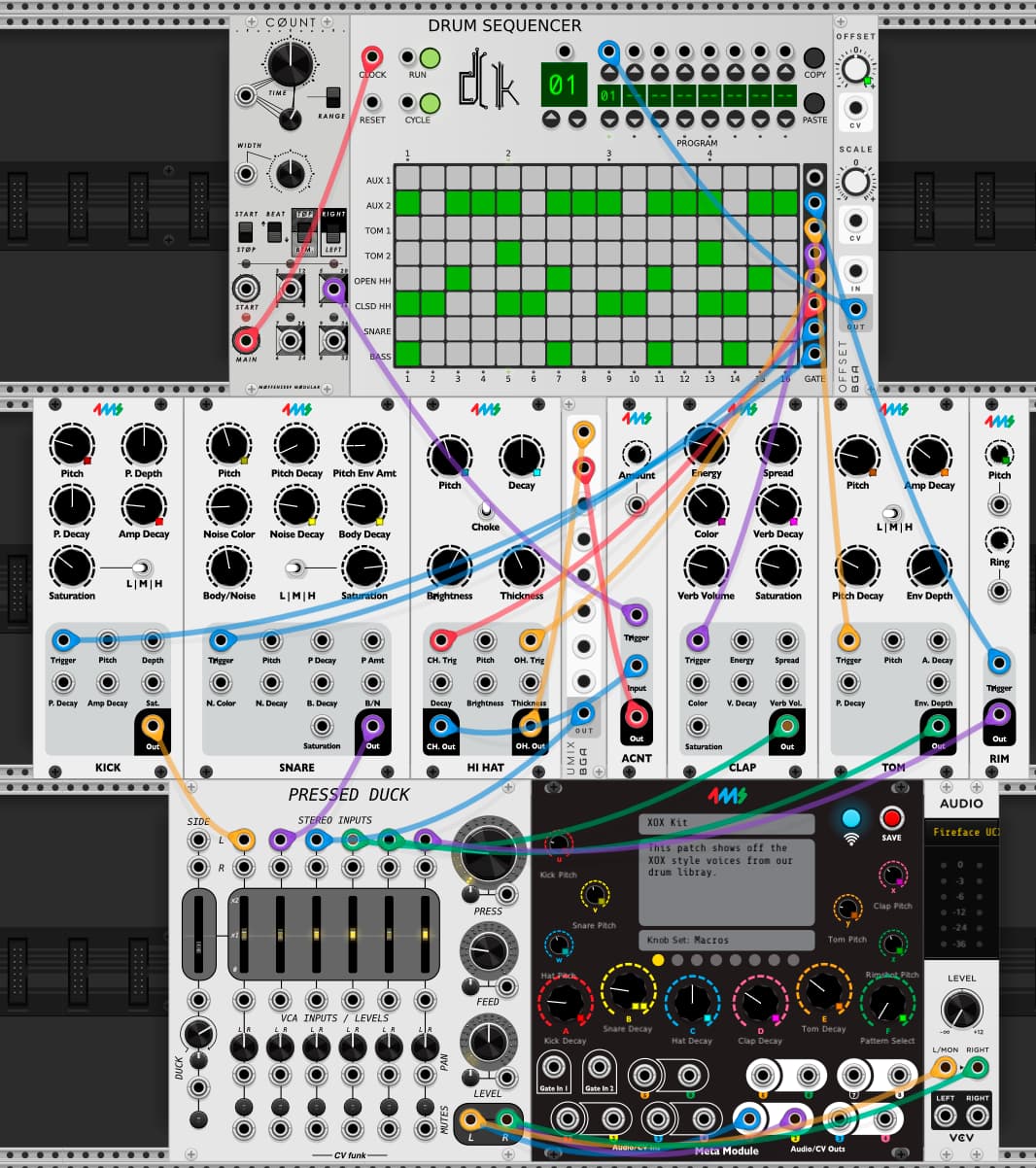

This is a demo of some of our new drum voices.
A 16-step drum sequencer is triggering the voices. Sequence selection, decay, and pitch are mapped to MetaModule’s knobs.
  • Main audio outputs are on channels 1 and 2.
  • The Closed Hi Hat is routed through an Accent Module, which receives a quarter-note clock.
  • The Closed and Open Hi Hats are summed together at unity gain with choking engaged.
  • The Kick, Snare, Hi Hat, Clap, Tom, and Rimshot are all mixed and compressed together using the Pressed Duck.
  • A Count Module is used as the master clock source.
  • The drum sequencer triggers all the drums and the accent pattern.
MetaModule Knob Mappings:
Knob Set 1 (Macros):
A - Kick decay
B - Snare decay
C - Hi Hat decay
D - Clap decay
E - Tom decay
F - Sequence pattern selection
U - Kick pitch
V - Snare pitch
W - Hi Hat pitch
X - Clap pitch
Y - Tom pitch
Z - Rimshot pitch
Knob Set 2 (Mixer):
A - Kick volume
B - Snare volume
C - Hi Hat volume
D - Clap volume
E - Tom volume
F - Rimshot volume
U - Kick pan
V - Snare pan
W - Hi Hat pan
X - Clap pan
Y - Tom pan
Z - Rimshot pan

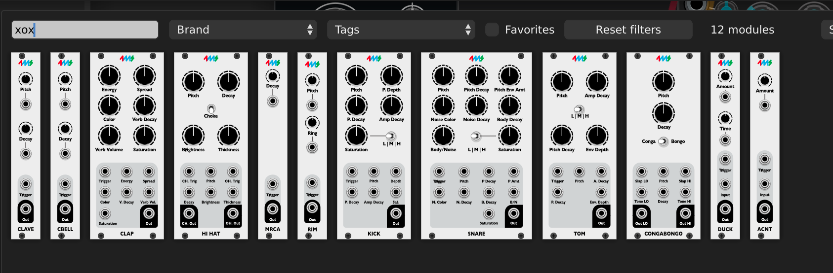

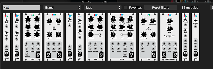

If you start typing “xox” in the module chooser, do you see them appear ?

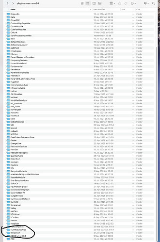

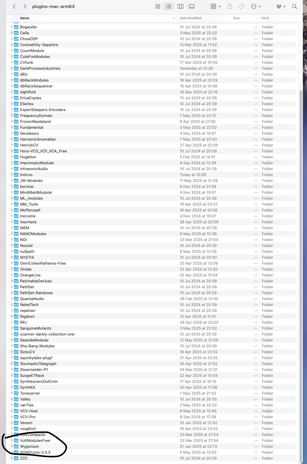

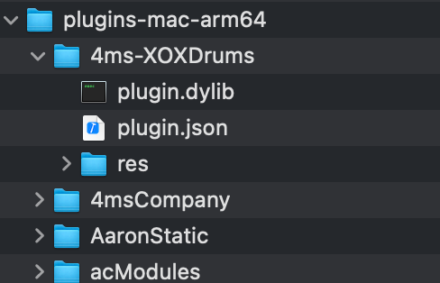

.. and to double check, do you see this in your rack plugins-mac-arm64 folder?
