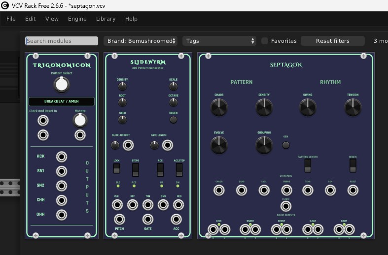

So far i have made:
Trigonomicon - a dream module of mine, no clue why no one has made it, it’s what got me into doing these modules. It’s a drum pattern generator with 60 (so far) built in patterns for jungle, breakcore, DnB, Drillcore, IDM etc. 32 steps. It has a mutate function for endless variations of these patterns. It’s awesome and i love it.
Slidewyrm - ported version of the really wonderful TB3PO (from ornament & crime) with some additions: accent out, auto accent on either step 4 or 8 or random. Slide amount, Gate length - both CV:able.
Septagon - a 7/4 drum generator (no built in patterns, entirely generative). Struggling slightly with performance here, the other two has great performance, not this one. 18-20% at 48KHz, so not good at all i think, will give it another pass. Has some cool features like generated velocity and outs for this. I do like the Trigonomicon better, so far.

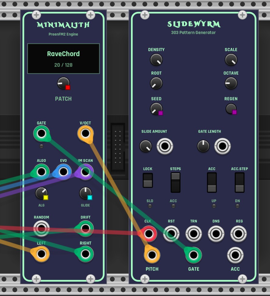

Ported PreenFM2. Much harder than e.g TB3PO, took a few hours. It was the MM port which was difficult, translated very easy to VCV i would say.
The original hardware version (in eurorack) has issues with glide, i made the AI take a look at that and it was basically down to the MIDI-implementation which did not translate over well to voltage controlled. It fixed this, which is great since i really miss having glide.
However, there is another issue with glide (also on the euro hardware) that i must look into, its down to use of glide and browsing patches while the unit is playing a voice, this can “crash” the voice and you have to restart the unit.
This version is stripped of Arp, filters, editor, midi. I thought it was probably a good idea to make it as minimal as possible. It can load my .bnk files fine.
So far it has 4 CV ins to shape the sound. you can also use a knob to switch Algo (the operator selection). So even if stuck to my banks you can still shape the sound somewhat. I might expand upon it too, any ideas are welcome.
Still early, might discover bugs, so far from finished.

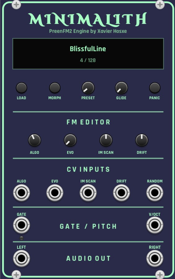

Against my better judgement (just purchased the MM audio expander) I purchased even more tokens. Whatever, i am having fun and i had some ideas i couldn’t wait to try out for MINIMALITH.
Who needs food anyways.
Since we are in VCV Rack, or on MM, we don’t want advanced deep digital parameter editing, so instead i added a MORPH function, and a save over currently loaded preset.
MORPH will morph 2 random presets from the currently loaded bank. The results can be really amazing and useful, i have come up with some of my favorite patches in the last hour just using that.
If that’s not enough i added (trimpots and CV-in)
ALGO
Switches the Operators.
EVO (Evolution)
introduces controlled variation to the patch so repeated notes don’t sound identical. As you increase EVO, the synth gently “evolves” aspects of the sound over time and/or per note, making the timbre feel more alive and less static.
IM SCAN (Index / Modulation Scan)
shifts the character of FM by scanning through modulation intensity relationships. In practice, it changes how “hard” operators modulate each other (the FM “index” behavior), which can move a sound from smooth and tonal to bright, metallic, or noisy.
DRIFT
Adds pitch and phase instability similar to analog oscillator “wander” and voice-to-voice detune. It’s meant to thicken the sound and reduce perfect digital precision.
design is not finished.
Nice sounds!

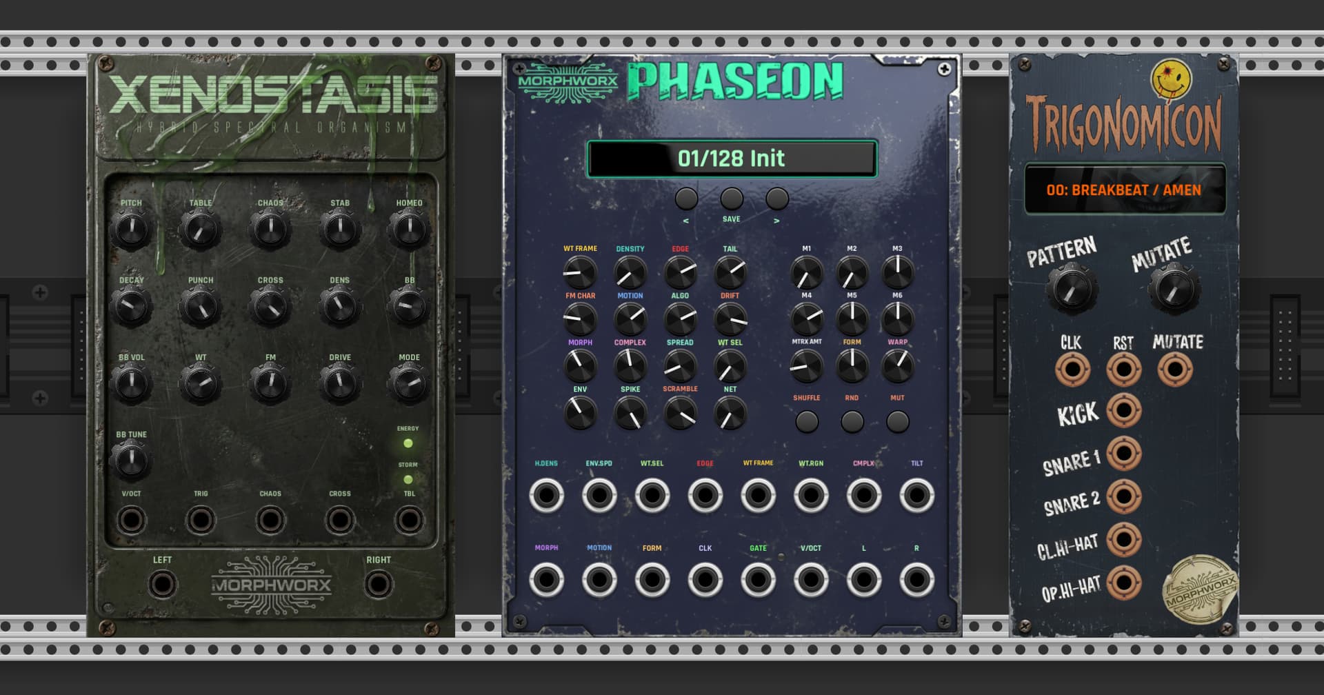

A New module:
Xenostasis - mix of Byte Beat, FM, Wavetable to create either drums (if using the trigger in) or alien textures / drones. Can actually sound kind of melodic too with some of the Byte Beat stuff.
Phaseon and Trigonomicon also got the faceplate updated.
All ported to MM. Xenostasis ~30% CPU at 48KHz, quite a bit higher than the others (around 15-20%)
Edit:
Long demo

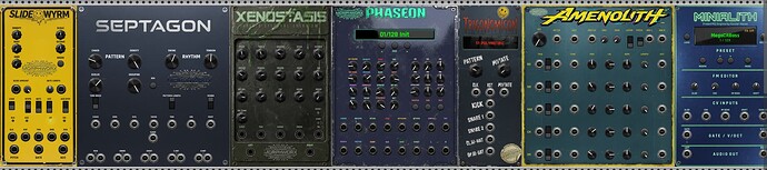

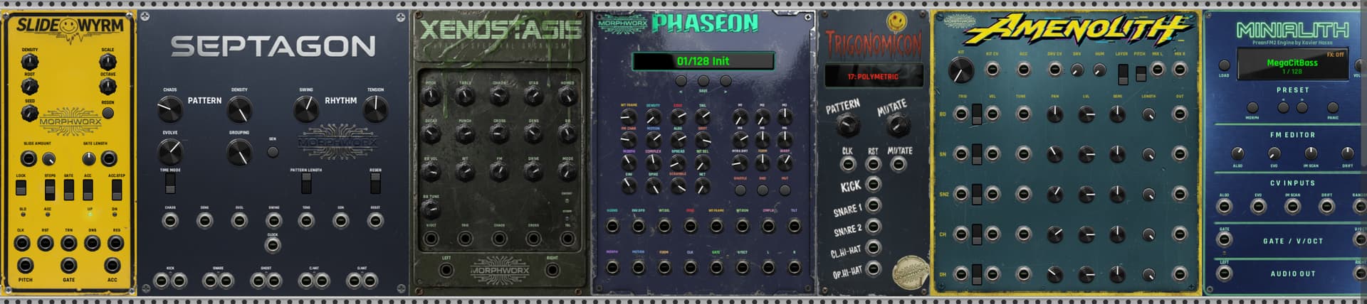

The full line-up with close-to finished faceplates
Thanks for your reply
Solid roadmap you’ve set :wink:
The design is really nice too
I’ll follow up for sure!
Good luck for the final rounds :wink:
