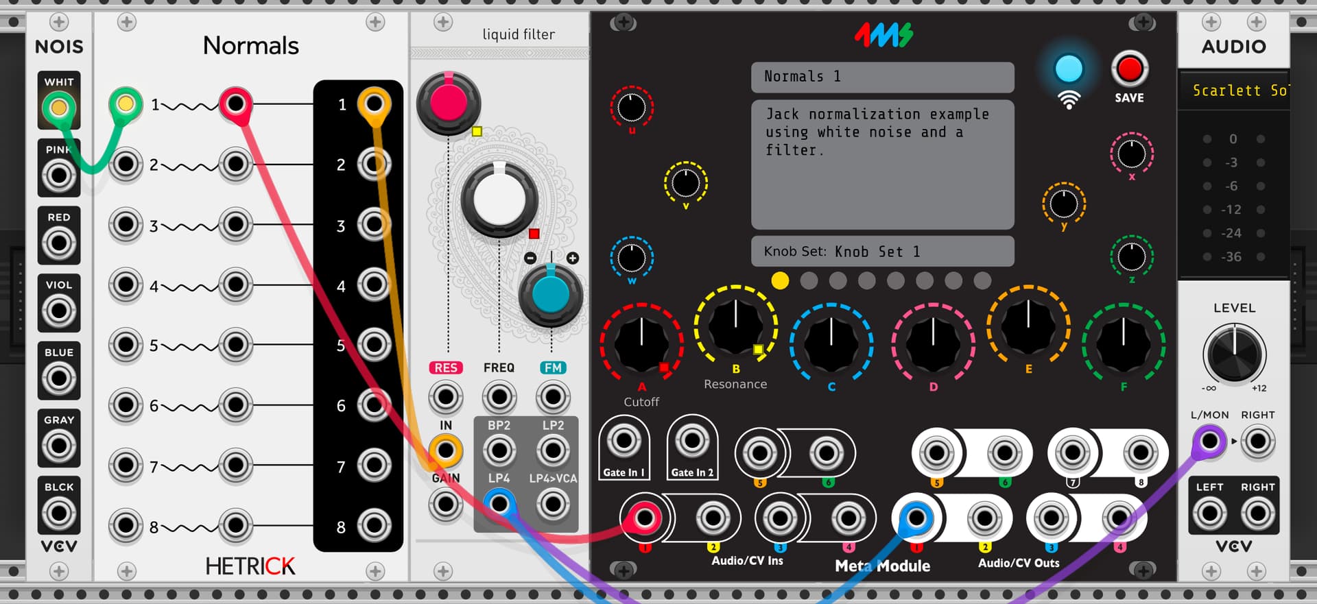

/// NORMALS 1 ///
-Main audio output on channel 1
-Main audio input on channel 1
-White noise is plugged into the switched inlet of normals.
-The output of normals goes into the audio input of the filter
-The filter goes out to the main output.
Metamodule Knob Mapping:
A - Filter cutoff
B - Filter resonanc

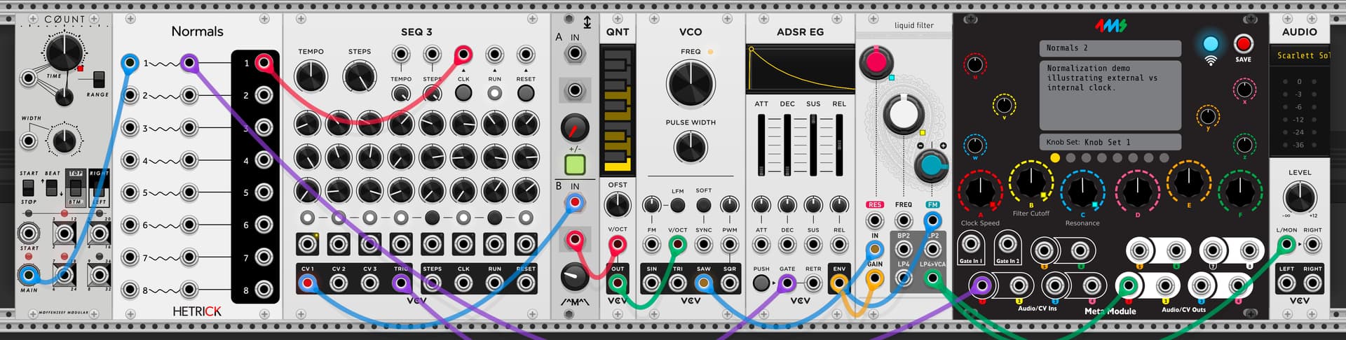

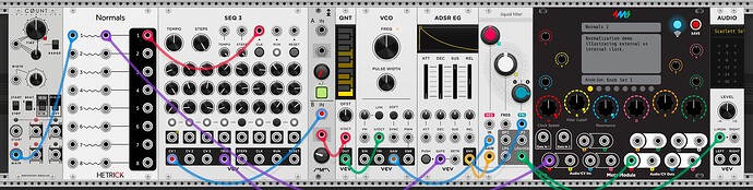

/// NORMALS 2 ///
External CV Path:
-Main clock input on channel 1
-A VCO is fed into a filter and VCA.
-An internal clock is patched to the switched inlet of Normals.
-The clock is fed to a step sequencer, which is then attenuated and quantized before being sent to the VCO.
-An envelope generator is triggered by the sequencer, which controls the cutoff of the filter as well as amplitude of the synth voice.
A - Internal Clock Speed
B - Filter cutoff
C - Filter resonance

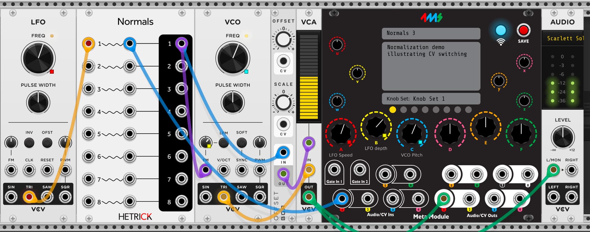

/// NORMALS 3 ///
External CV Path:
-Main CV input on channel 1
-A VCO is fed into a a VCA
-An internal LFO is patched to the switched inlet of Normals.
-The output of normals is fed into the CV input of a VCO as well as a VCA.
-The LFO is biased with a 5v offset to keep the modulation signal in an entirely positive range for the VCA
A - Internal LFO speed
B - Internal LFO depth
C - VCO pitch

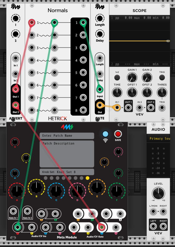

worth mentioning (although more esoteric use case), normals can be used to send gate or triggers when a cable is plugged in:
very nice! true “cable detection”
