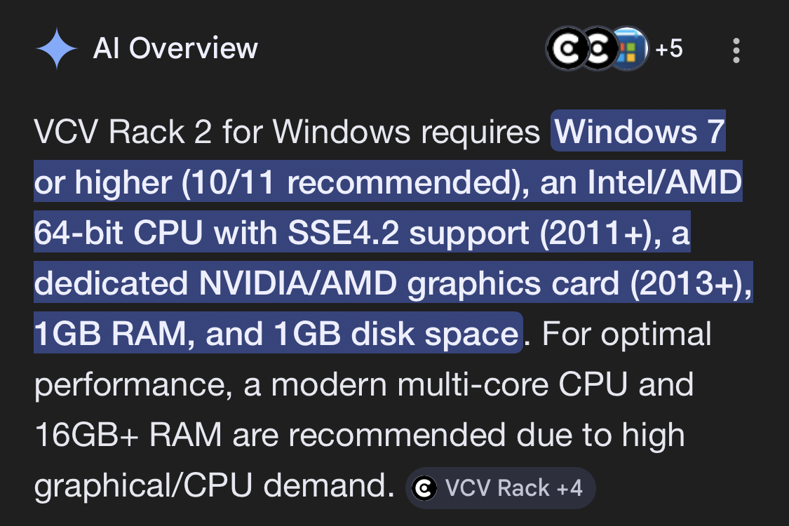

vcv is available for windows as well so you’re in luck there! no need to mess with linux. although i’ve never used win 8, quick search shows it “should” work ok?

Yeah, I don’t know what it is , maybe the graphics card on early surface pro ( it’s only a 3 )??
It loads up BUT it’s waaaay too flakey to get anywhere with..

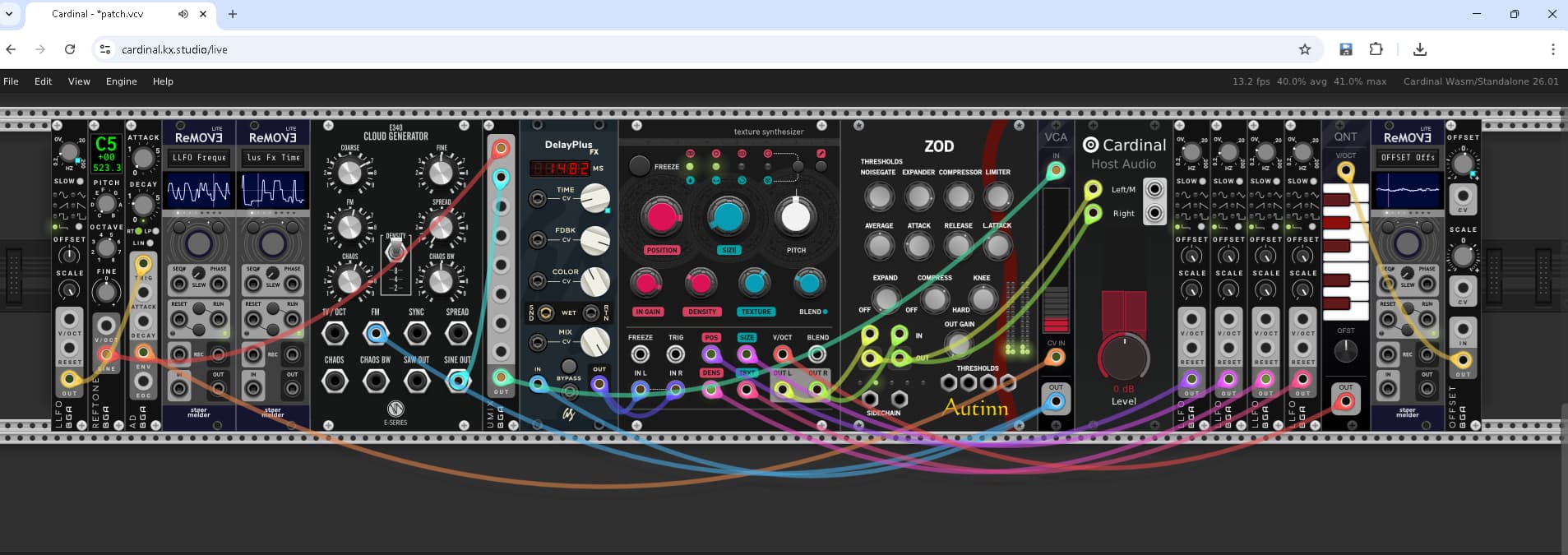

its interesting you mention that, cardinal vcv has a ‘live’ web version:
i was able to get some sounds out of it via safari on my iphone but i haven’t tried other browsers such as chrome
yeah, cardinals approach is the ‘right one’, use the vcv code base to load and export.
trying to load and convert a vcv patch without using vcv code base is fraught with issues, particularly patch and module versioning, and the fact you need to ‘host’ a module to inspect the meta data.
sure, you could ‘do it’, but its non-trivial.
can confirm, cardinal web works ok in chrome, albeit the audio is a bit glitchy. setting engine-buffer up to 16384 helped
patches don’t save online afaik, but you can download/import them no problem

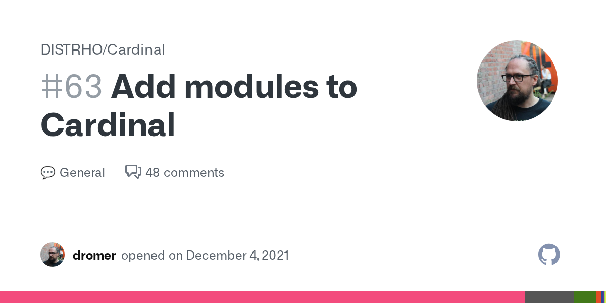

how does cardinal decide what plugins to ‘host’?
e.g. I notice they dont have any of the 4ms modules
in theory if you wanted to do this for MM conversion only,
you could create a fork of vcv (and 4ms hub) , which could load patches, add the 4ms hub, then force the hub to export as a yml.
you could run that on a pretty low powered server, as you are not interested in the audio… just using the vcv and 4ms code to to the patch conversion.
its still a pain that you have to have access to all vcv modules you want to convert, as that list is not static -but a bit more code, and you could automate that too.
but yeah, a lot of effort to support probably not that many users.
basically comes down to license type and falktx’s preference.. lots of discussion about it here:
at one point i noticed they attempted to add the 4ms line in there but the build was failing for some reason. hoping he tries again with that down the road. i have a feeling he’s run out of steam a bit on the project.
ah, yeah, I see they use the same approach as miRack (and MM simulator) where they compile in modules statically.
ouch, yeah, whilst thats ‘easier’ it creates a bit of a maintenance nightmare.
I can see that’d get tedious after a while :wink:
Im surprised they dont run on a ‘compatible server’, and just pulls the vcv module binaries. perhaps, vcv has something in the ToS which prevents this.
