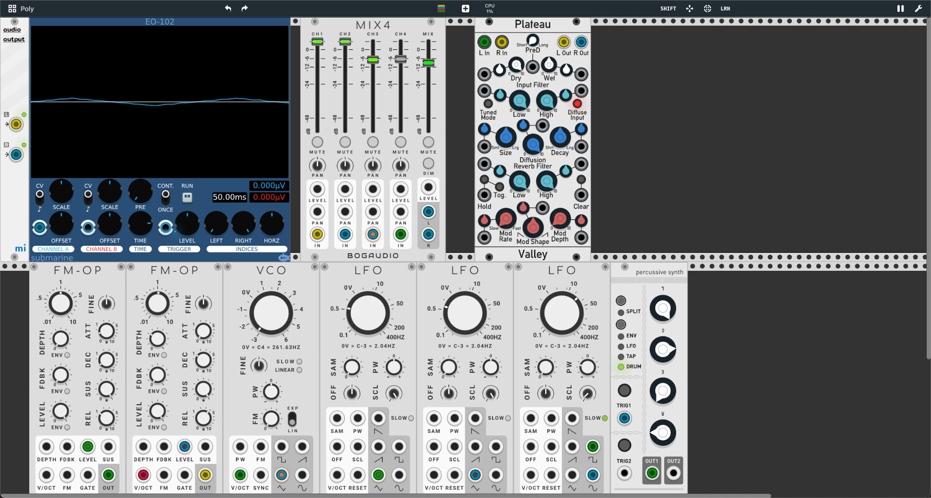

interesting to note that i was able to import a mirack patch into the web version of cardinal vcv and it loaded/worked just fine - all wires in tact, all knobs at the correct position. i tried this experiment using this simple mirack patch that contains only bog/valley -
loaded into cardinal live/chrome (windows 11):

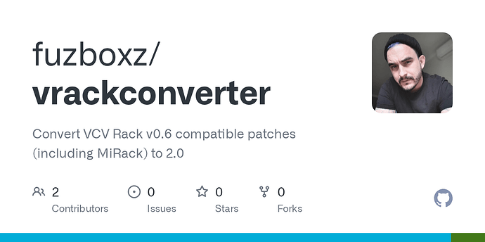

I made a small command line utility that does the MiRack(old VCV Rack) → VCV2 conversion (hopefully) without missing cables. I tested it with MiRack on MacOS to latest VCV Rack 2, but there could still be issues. If you find an issue, please send the files as well and a description of the problem.
Binaries and source code are provided for Windows, Linux, MacOS both x64 and ARM for all OS.
edit: v1.01 contains flag that adds MetaModule automatically if --mm is passed to the command line.

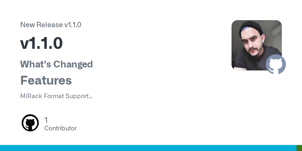

I released a new version that allows bidirectional conversion from/to MiRack with new source and target formats planned. There are a few small bugs for MiRack target due to differences between how MiRack and VCV v0.6/2 handles audio I/O modules, but I plan to fix them soon. MiRack uses separate audio in and out while VCV uses a shared audio interface, so I have to merge/split during conversion.
