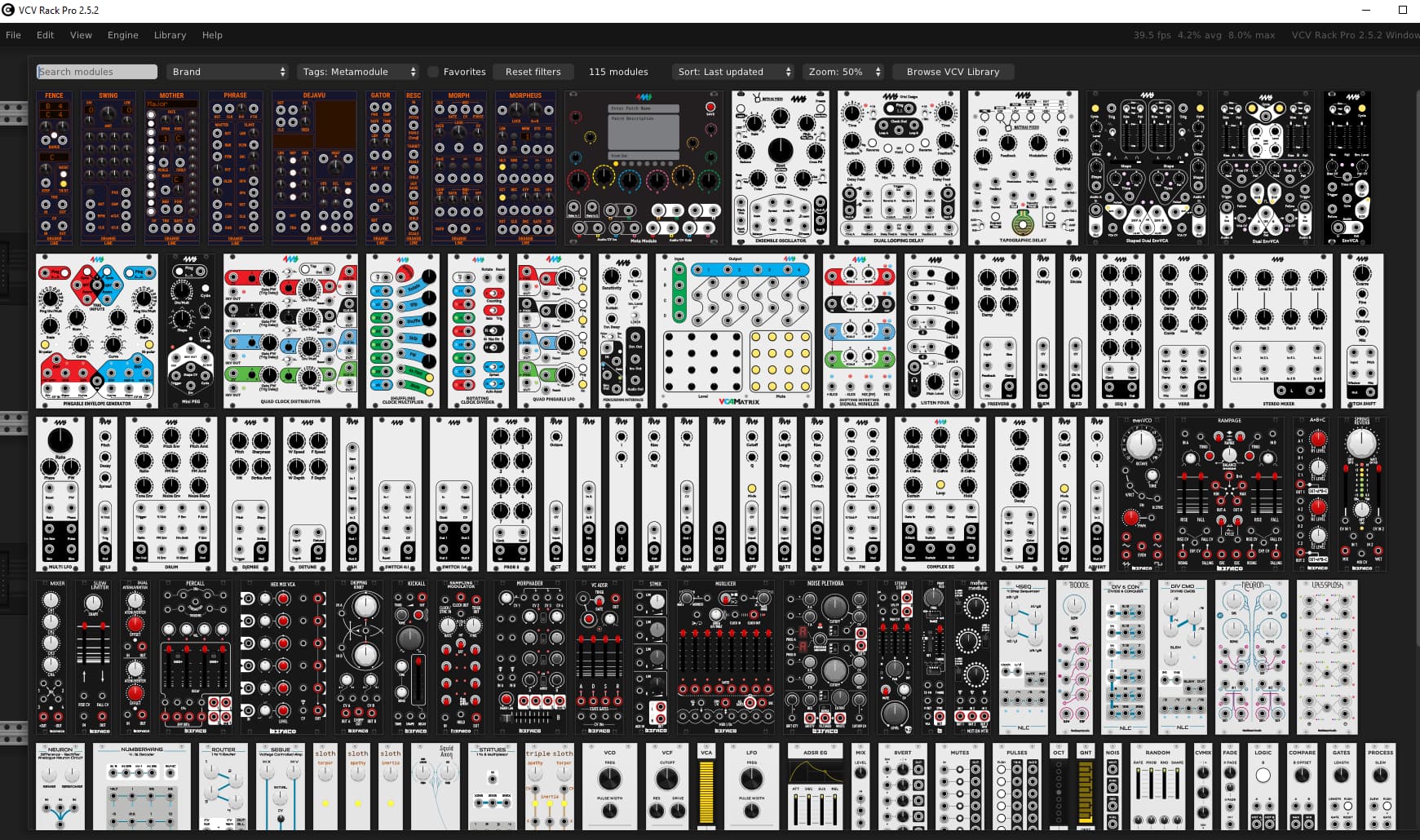

ooh! Thanks @danngreen ! good call! I made a build of libRack.dll and added a “Metamodule” tag (no longer stealing the “Compressor” tag)
** VCV Rack version 2.5.2 FREE Only! Will not work with Pro! **
Instructions:
  • download libRack.dll
  • Ensure VCV Rack is closed
  • Go to C:\Program Files\VCV\Rack2Free
  • Rename libRack.dll to something else, like libRack_OLD.dll
  • Copy the downloaded libRack.dll to here
  • Open VCV Rack
