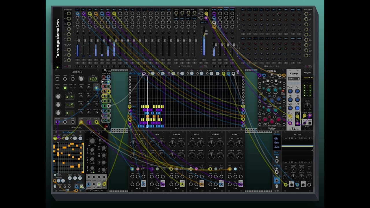

new module in beta called “Arrange”
That is AWESOME!!!
Your modules bring me joy. TY.
now THAT looks juicy!!
loving the idea of being able to explore building up song structures on mm
It will be in the vcv library soon so you can actually make patches with it.
its out in the vcv library! https://library.vcvrack.com/
Fantastic :grinning_face: can’t wait to try it out. :folded_hands: thanks.
I have been putting it through its paces and it is a game changer! Right now, I am using it as a trigger sequencer and it works great for that application as well as for audio.
Ah, this is such a clever design. It’ll really help with the problem of song structure in Eurorack.
ya if you use it for triggers instead of audio then you don’t lose any effects tails or note releases.

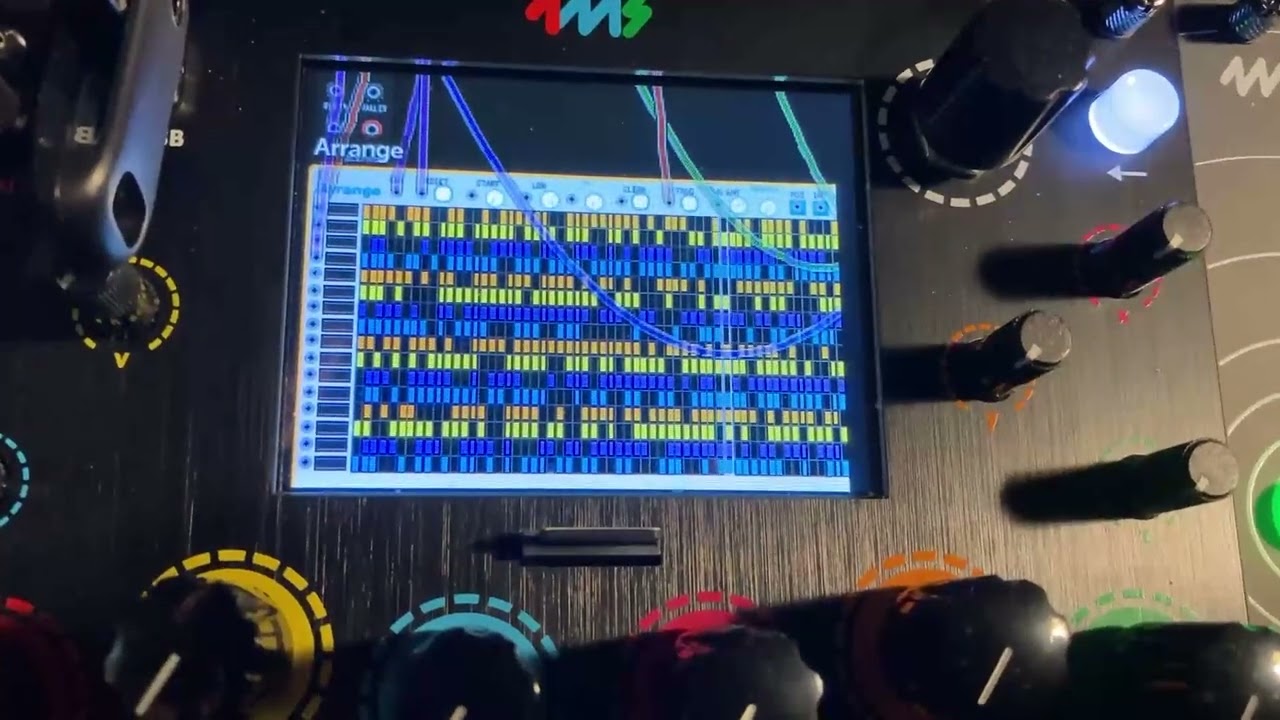

Here is the version I made with the MM and JW Arrange.
