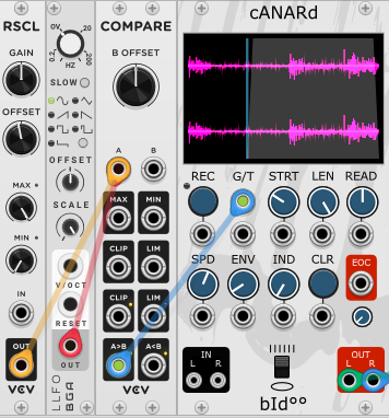

more experiments, am able to get the gate in to work with an lfo (or offset+knob mapping) running the lfo through a comparator that just spits out full on or off, nothing in between. i guess that’s the trick to make canard happy. so i recant about avoiding gate in4. no doubt its wonky code under the hood, but it seems to be working ok more or less w the compare module
