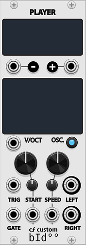

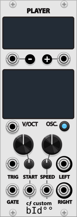

as far as other library, voxglitch have a bunch of awesome samplers(specifically the looper or repeater modules). CF is an old school (pre1.0vcv) line that has a sampler player ive used a bunch in the past. it’s interesting the panel says ‘bidoo’ on it but after testing it in vcv, it doesn’t have the truncation problem as all the bidoo ones have.

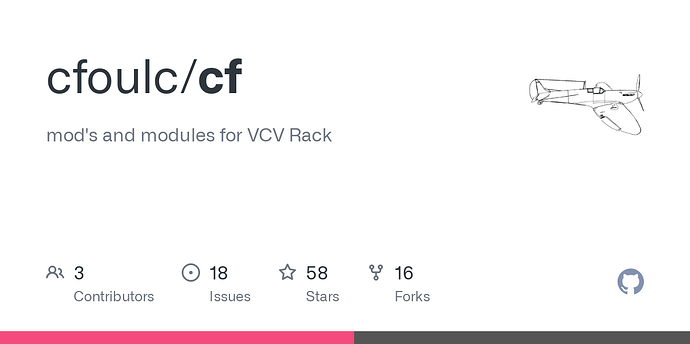

reported the bug here so hopefully will see a fix at the source at some point:
