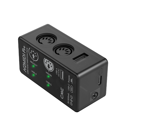

Would this be a good solution compared to the DIN-to-USB converter?

Yes that is the one for a midi keyboard, there are USB-C ones to save you using the USB-A to USB-C at the end. As for the iPad, I have no idea, sorry, but may not be $9.99.
