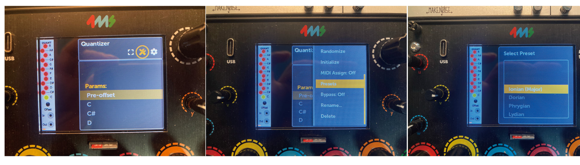

Just like in VCV Rack, you can find presets under the tool icon, where a full selection of scales is available. Of course, you can also edit them directly using the keyboard interface. Once you select the notes you want, you can turn each note on or off—meaning you can customize a scale freely in any situation.

What would be great is if we could map a meta module knob to the preset list and scroll through it.
