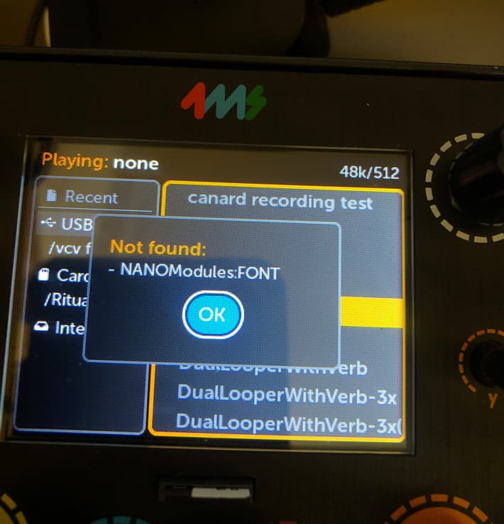

loving the new autoload and auto rate/buffer settings! but i’m getting this error when loading patches that use the nanomodules ‘font’
this is with 2.1.4 and all the latest plugins
trying to load this patch:
Probably the NANOModules issue discussed here: Settings, plugins don't save. 2.0.10 - #10 by danngreen
