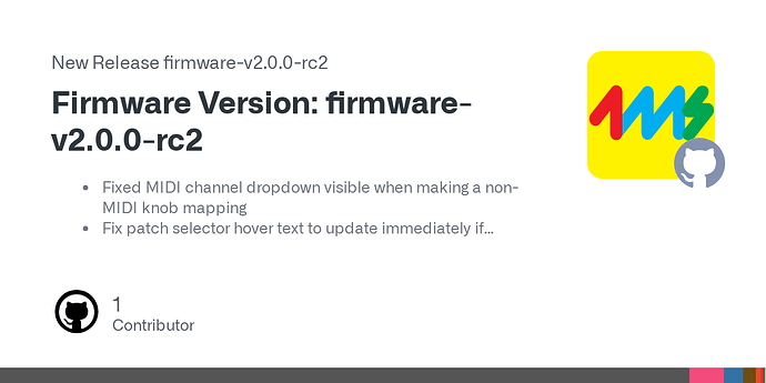

Ok, try this one:
just tried out rc2, i noticed the faster 35s load times, nice! but unfortunately still crashing when loading the patches. my first run through, it froze when trying to load 03. the second run it froze when attempting to load 05.
OK, thanks. I’ll work some more on canard.
