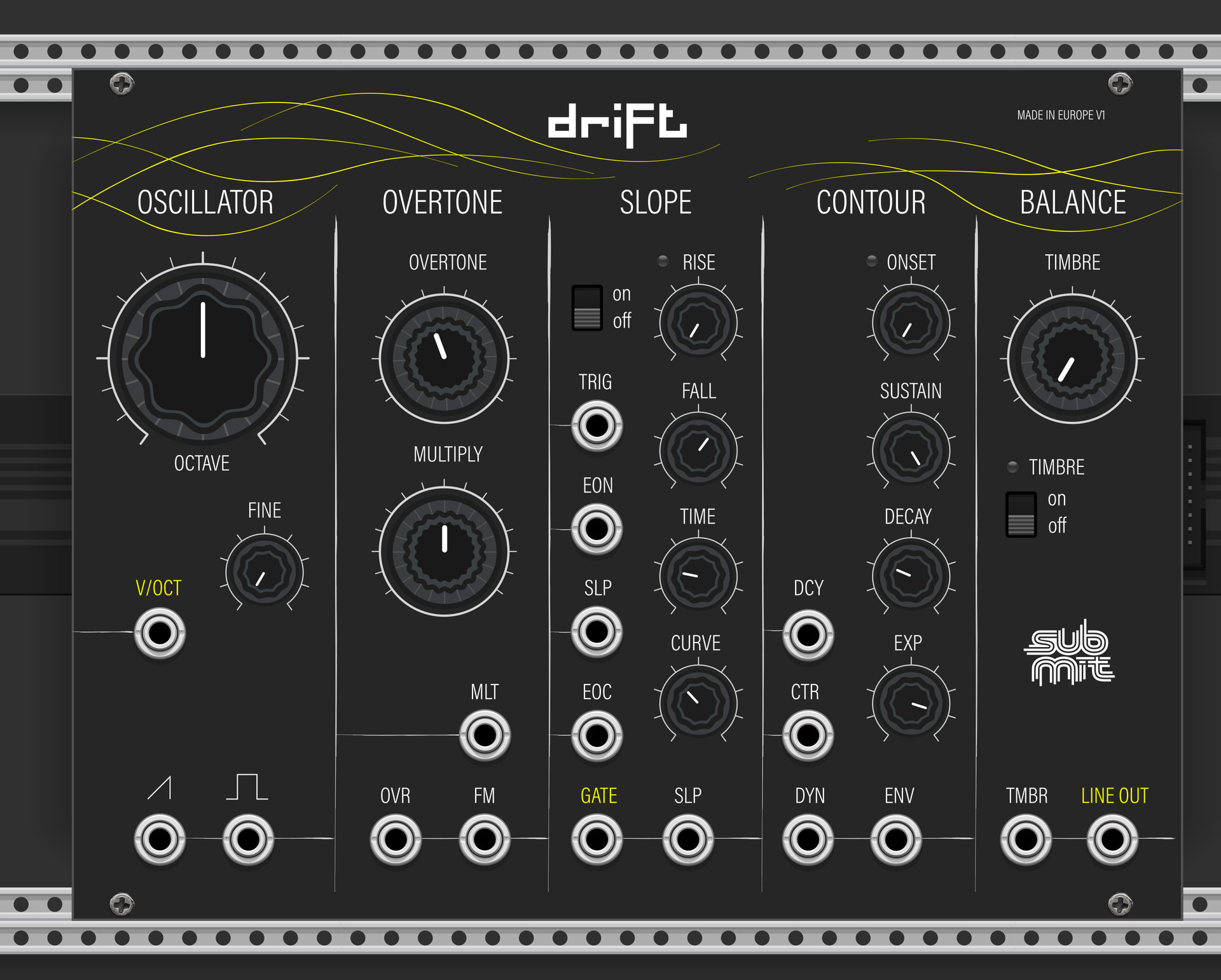

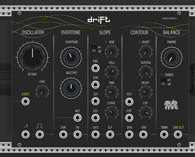

My first semi-modular was the 0-Coast. I used it for years, sold it… and yeah, I still miss it sometimes.
That’s what pushed me to build my own module — inspired by that idea, but definitely not a clone. Drift has its own character, its own quirks, and its own sound.
This is my first module, so I figured: why not start with something that really challenged me.
Right now this is the first beta, only for VCV Rack. I’m still testing and shaping it, and once I’m fully happy, I’ll also build a version for the MetaModule.
If you feel like trying it:
download it, play with it, break it
and let me know what you think — all feedback is welcome
Please make sure you’re using VCV Rack 2.6.x (the plugin was built with SDK 2.6.6).

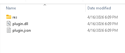

Place the .vcvplugin file in:
C:\Users[yourname]\Documents\Rack2\plugins\
Not in the VCV Rack installation folder itself.
After placing the file, restart VCV Rack completely.
If it still doesn’t show up, please let me know:
Your VCV Rack version (Help → About)

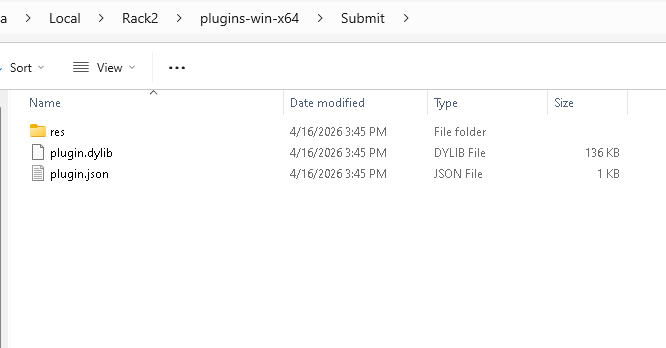

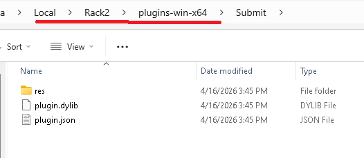

-A screenshot of your plugins folder

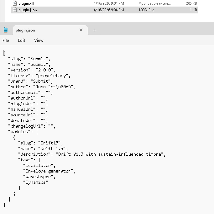

Rack’s log has the actual failure:
“Could not load plugin … Submit: Plugin defines module Chrono but it is not defined in manifest”*
What I found:
The manifest sets brand to Submit, so the brand field itself is not the problem.
The manifest only declares one module: Drift13.
The DLL exports both modelDrift13 and modelChrono.
The res folder also contains both Drift13.svg and Chrono.svg.
So this looks like a manifest/code mismatch: the binary is registering Chrono, but plugin.json does not include a Chrono module entry. Rack rejects the whole plugin on that error.
Most likely fix for your friend:
Add a Chrono entry to plugin.json if that module is meant to ship.
Or remove the p->addModel(modelChrono) registration from the plugin init code if Chrono is not supposed to be included.
Thanks for the detailed log — that was exactly what we needed!
The issue was a manifest/binary mismatch: the compiled DLL was still registering a modelChrono module internally, while the plugin.json manifest only declared Drift13. VCV Rack rejects the entire plugin when it detects this inconsistency.
Fix applied:
Removed p->addModel(modelChrono) from plugin.cpp
Removed extern Model* modelChrono from plugin.hpp
Rebuilt with the official VCV Rack plugin toolchain
A new build (v1.3-beta4) is now available — hopefully this resolves the loading issue on Windows!
