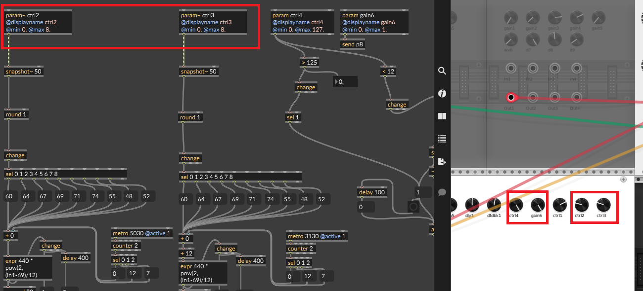

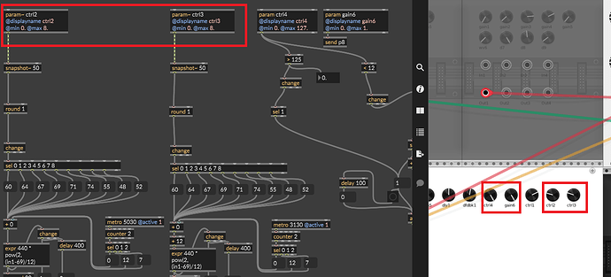

i’m noticing that param~ ones are getting sorted out of order, to the far right. is this expected behavior (i had to start using these param~ + snapshot ones due to some weird bug, without that setup using regular param, when turning the knob quickly in vcv, caused the module to stop working)?

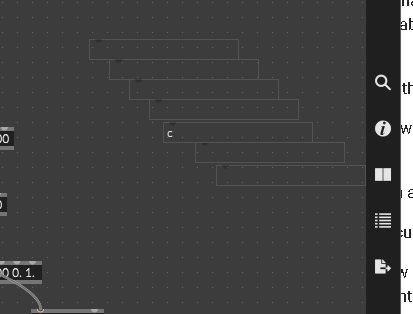

also i noticed some empty comments left in your starter template. are those needed for any reason (edit: having removed these and built a few times, not noticing any problems so am assuming ok to delete these)?
