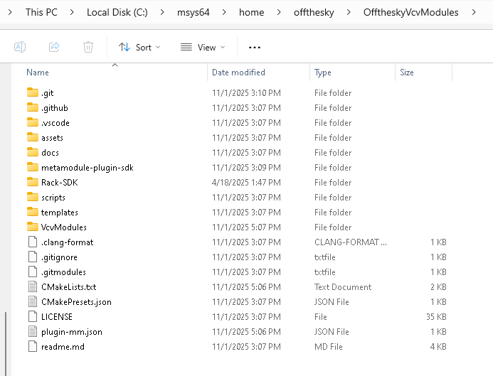

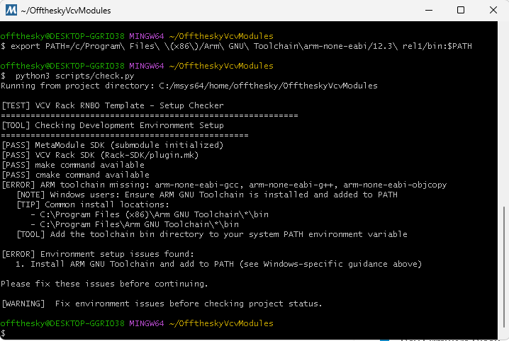

so was able to get everything cloned and the sdk in the right place. unfortunately followed your instructions in the video to do it via shell, but it didn’t work (shell stated no such path for file, something like that). but was able to manually unzip it and move the “Rack-SDK” folder into here: “C:\msys64\home\offthesky\OfftheskyVcvModules”.
upon running the first test “python3 scripts/check.py” i’m seeing an error related to the arm path:
as you can see i had run this (and that seemed to work ok?):
export PATH=/c/Program\ Files\ (x86)/Arm\ GNU\ Toolchain\arm-none-eabi/12.3\ rel1/bin:$PATH
maybe this arm path issue is something to do with the error/warning when its validating metamodule plugin-mm.json you mentioned above?
sorry, don’t worry about that its. misleading… it should not be an error, just a warning/reminder for windows about the path.
just continue :slight_smile:
(Ive very limited access to a window machine, so Ive not been able to get a chance to clean this up)
nope, completely unrelated.

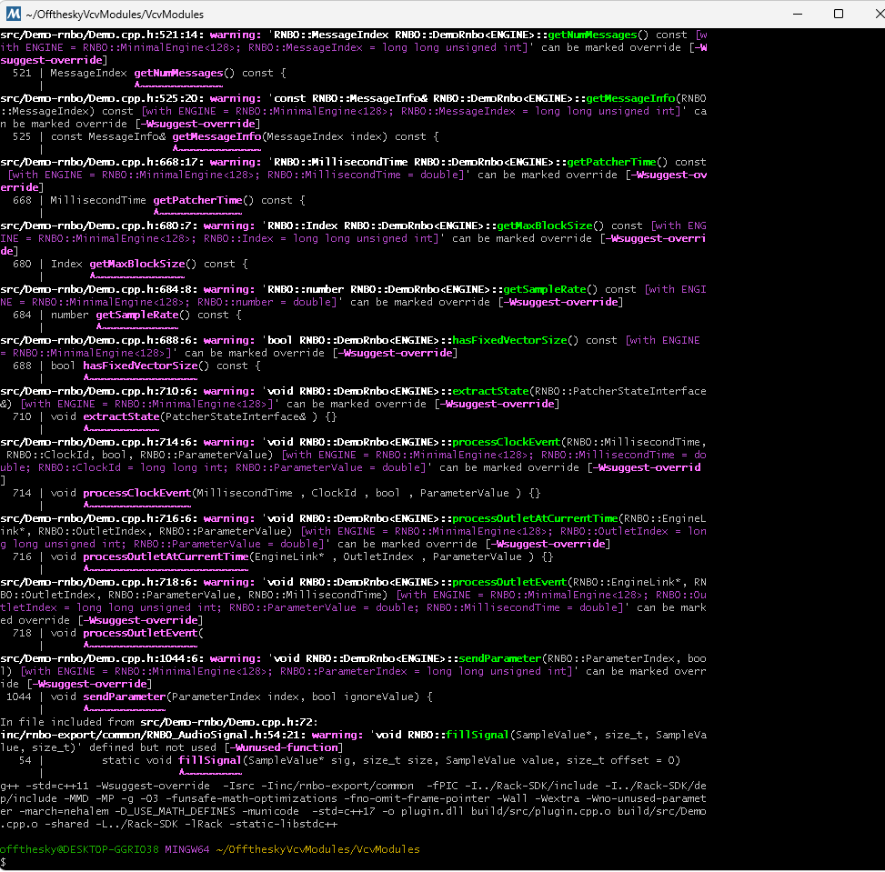

ok awesome! so i was able to get as far as the “build for vcv rack” stage
typed in cd VcvModules && make and got::
im not finding any .vcvplugin file here C:\Users\offthesky\AppData\Local\Rack2\plugins-win-x64 or in here (i’m guessing im just doing something wrong here :slightly_smiling_face:):
cool…
as per instructions - creating modues
Test in VCV Rack (Recommended): copy and install plugin into VCV rack
make install
(assuming you have VCV Rack installed, and have run it previously)
or, alternatively (as mentioned in setup.md)
make dist
and then the package will be in the ‘dist’ subfolder.
note: in both these cases… the instructions had asked you to change directory into VcvModules,
so cd VcvModules
basically VcvModules is the VcvRack build, whereas this root directory is where metamodule build is.

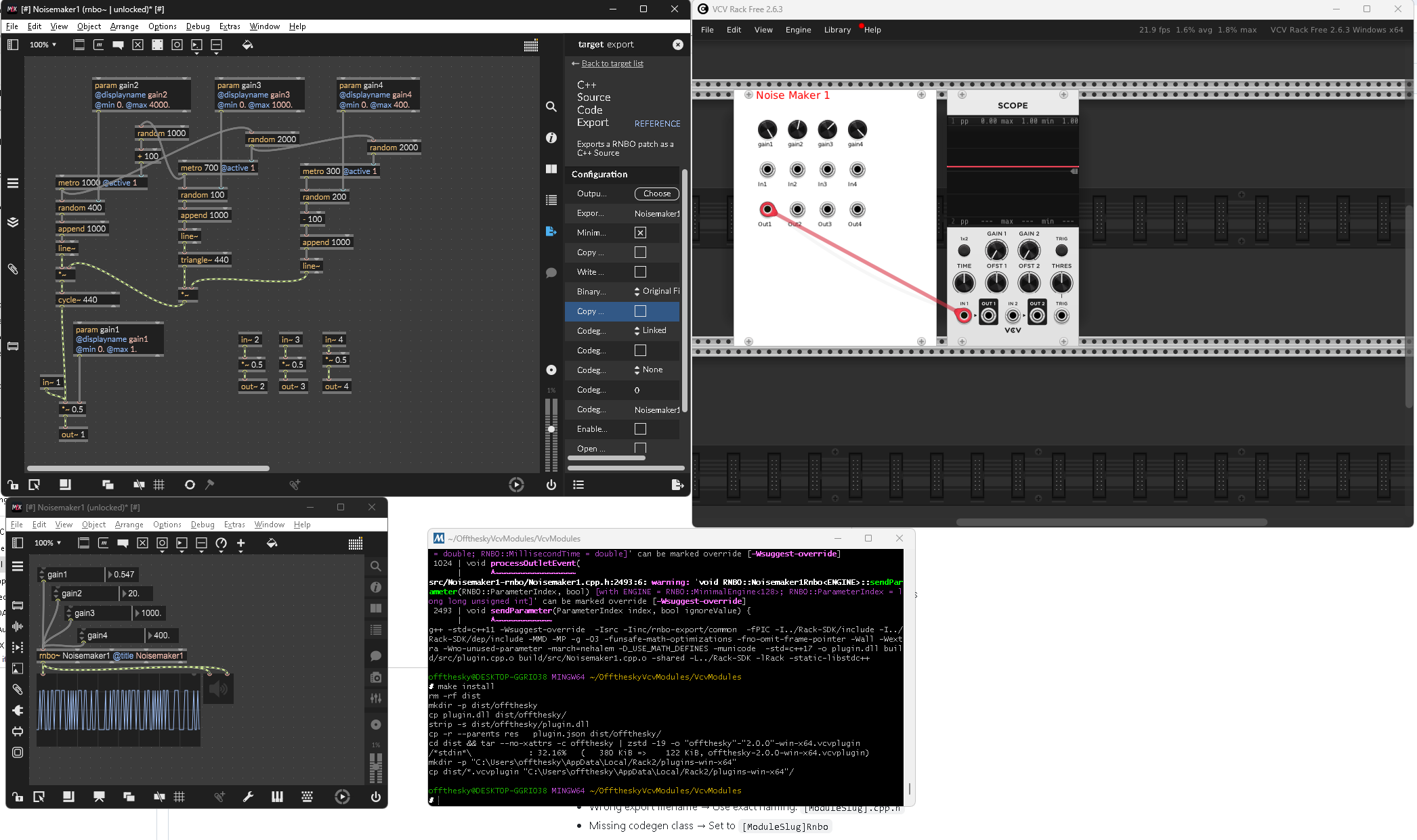

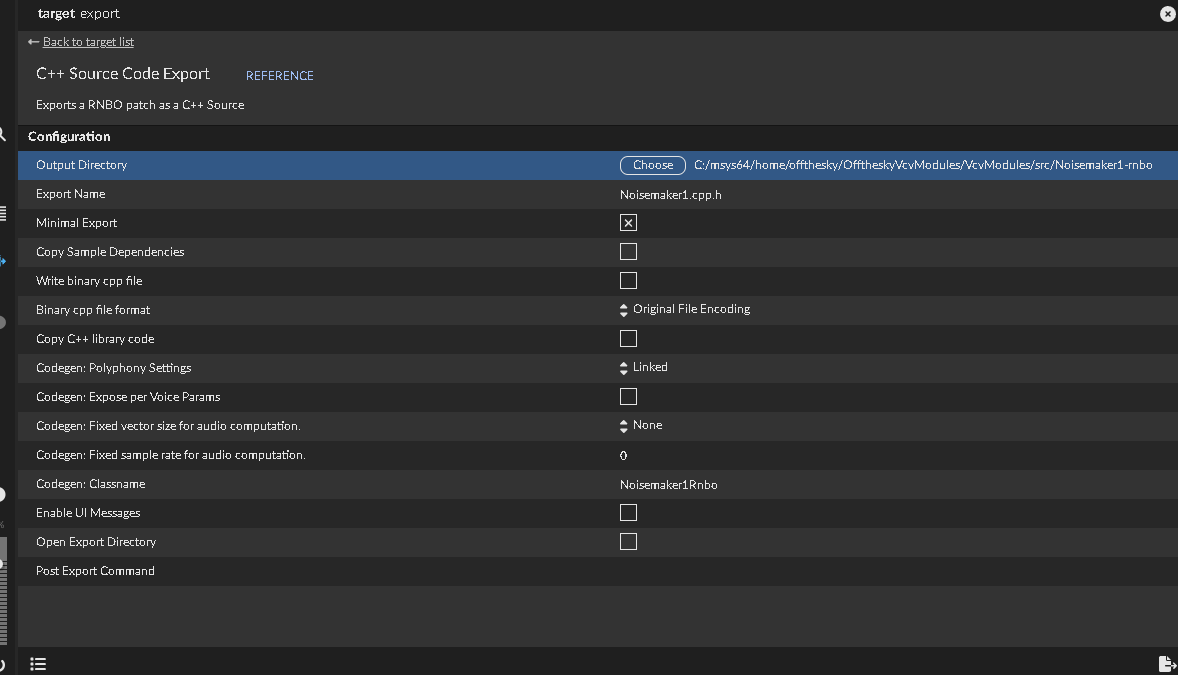

so i was able to get a module to load in vcvrack, however it’s not spitting out any audio in vcv. it emits sounds ok as expected in max. i believe i set everything up ok when exporting the c code:
i’m also noticing some odd behavior in vcv (beyond the module not emitting sound properly) now after installing the plugin. when i right click to open the browse in vcvr, often that crashes vcv. i’m guessing this has something to do with the issues with my plugin/module?
any insight is great appreciated! we’re getting close here i can feel it :smiley:

I’ve have found an issue, which Ive fixed, ( * )
can you post the patch here? (or somewhere I can get hold of it)
I’d like to test with your patch, just to see if it’s something else.
(so, you only have to do one update)
I did a test which was outputting noise, and it was working fine.
( * ) I was using my own build of vcvrack to test, and found an issue when using the released vcvrack version - now fixed.

yes no problem! sending you a pm with the maxpat and rnbopat
very cool! can’t wait to try out the making custom uis section
ok, you can update your repo, as described here…
basically, if you forked my repo, use :
git fetch upstream
git merge upstream/master
git submodule update --init --recursive
you’ll see it update a bunch of file during the merge
you then need to create the module again (so remove then create again),
so that the new template code is used.
hopefully this’ll fix it, at least works for me with your patch.
you can then try on the metamodule … hmm I should do this too :wink:
(edit: yup works on MM)
