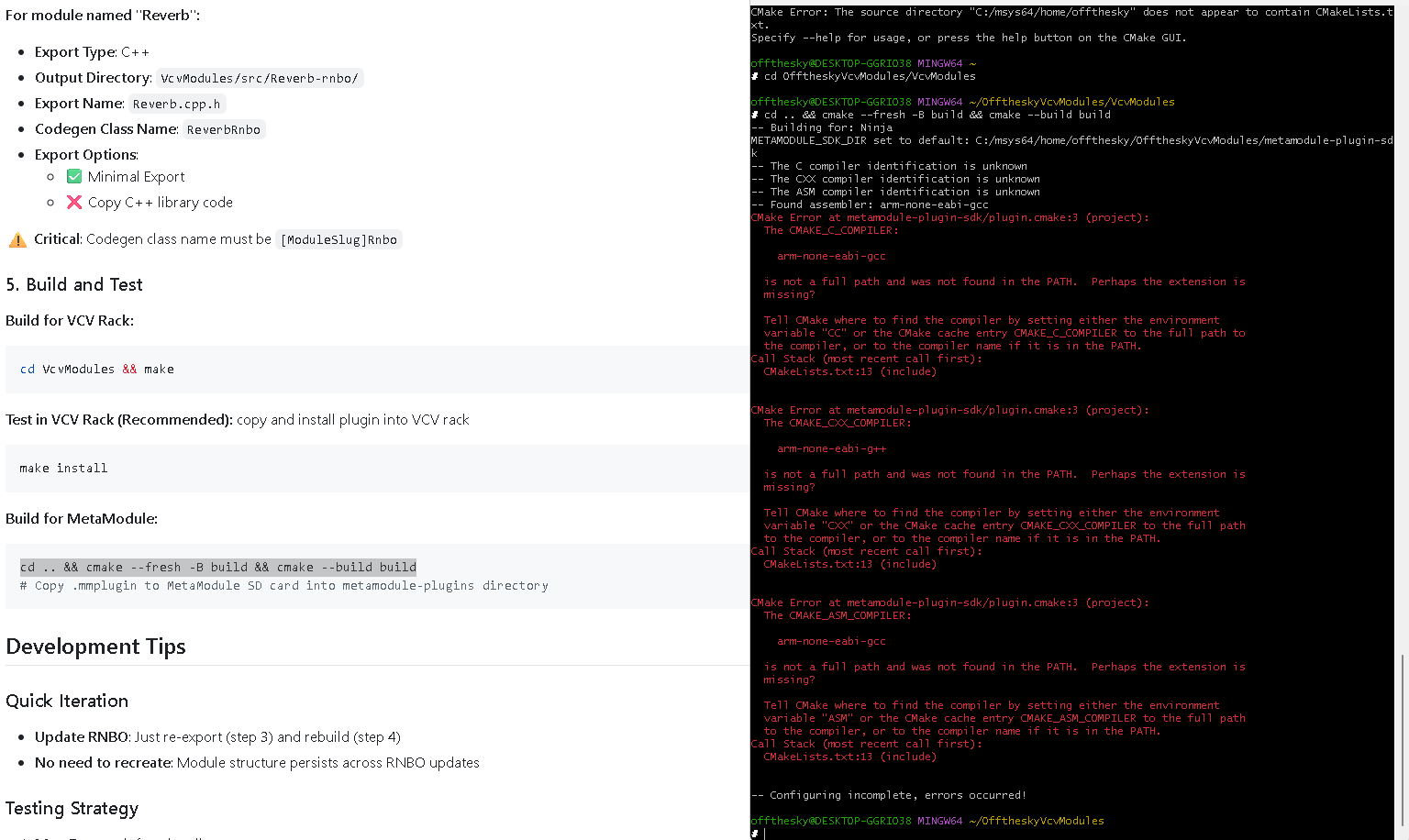

so now im attempting to build a .mmplugin for the first time. but i’m running into errors. looks like it can’t find the arm stuff:
i setup the path to the arm install as stated in the setup instruction:
export PATH=/c/Program\ Files\ (x86)/Arm\ GNU\ Toolchain\arm-none-eabi/12.3\ rel1/bin:$PATH
when i paste that line into the shell and hit enter, it doesn’t spit out any info, is that normal?

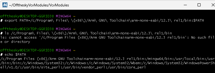

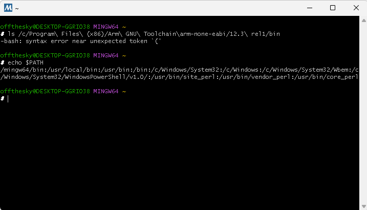

this is what i’m seeing when i run those commands - looks like some kind of syntax error:
by export you mean - export from rnbo? and by 'open the session ’ you mean open “MSYS2 MINGW64 Shell”?
so after updating my fork i removed the module as you advised, then i followed steps 3-5 in the create module section. instead of ‘make install’ i did a ‘make dist’ (as you had suggested earlier, just to try that out). i assume that wouldn’t have any effect on the build for metamodule step?
ok, we have a bit of cut n’ paste errors going on there :laughing:
it is :
export PATH=/c/Program\ Files\ \(x86\)/Arm\ GNU\ Toolchain\arm-none-eabi/12.3\ rel1/bin:$PATH
and
ls /c/Program\ Files\ \(x86\)/Arm\ GNU\ Toolchain\arm-none-eabi/12.3\ rel1/bin
note: we are missing \ before the brackets.
ok, but echo $PATH shows me you have not done the export (or it didnt work?),
if had been done, echo $PATH would show something like :
/c/Program\ Files\ \(x86\)/Arm\ GNU\ Toolchain\arm-none-eabi/12.3\ rel1/bin:/mingw64/bin:/usr/local/bin:/usr/bin etc etc
you need to do this each time you start MSYS2, so that the arm toolchain is on the path.
copy/pasted those recent lines and this is what i’m now getting (“No such file or directory”):
when i ‘copy as path’ one of the exe’s inside that bin folder, this is the path windows gives me:
"C:\Program Files (x86)\Arm GNU Toolchain arm-none-eabi\12.3 rel1\bin" - that seems to match up with your export path?

hmm, and after the export you still get the same error from cmake?
once the export is on the path, you should be able to execute any of the files in that bin directory. which is basically what cmake was complaining about.

yes unfortunately same arm path error as before
ah ok i found the issue: you needed a space between "Toolchain" and “arm-…”.
these are fixed ones:
export PATH=/c/Program\ Files\ \(x86\)/Arm\ GNU\ Toolchain\ arm-none-eabi/12.3\ rel1/bin:$PATH

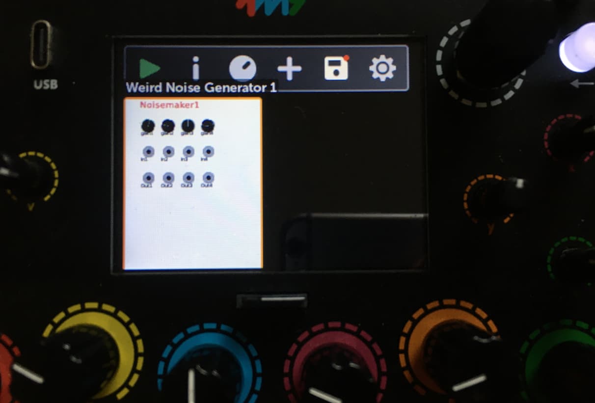

a lot of things on windows don’t make sense so maybe they just wanted to add to that haha. at any rate, the .mmplugin is works/sounds great on the mm! super cool! ty for all you help on this

Re: the json error, I found it works if you use the MSYS Makefiles generator when using msys. So:
cmake --fresh -B build -G "MSYS Makefiles"
Then it works. The problem is the two types of paths on msys/mingw/windows (C:/... vs /c/...). Using MSYS Makefiles “just works”. I’m updating the sdk README to include this.
BTW I played around with trying to convert the path from within cmake, but couldn’t get it to work without lots and lots of checks and running external programs. Detecting which type of path the currently running shell will want is not simple… I suppose that’s why there’s a cmake generator to handle all these issues.
