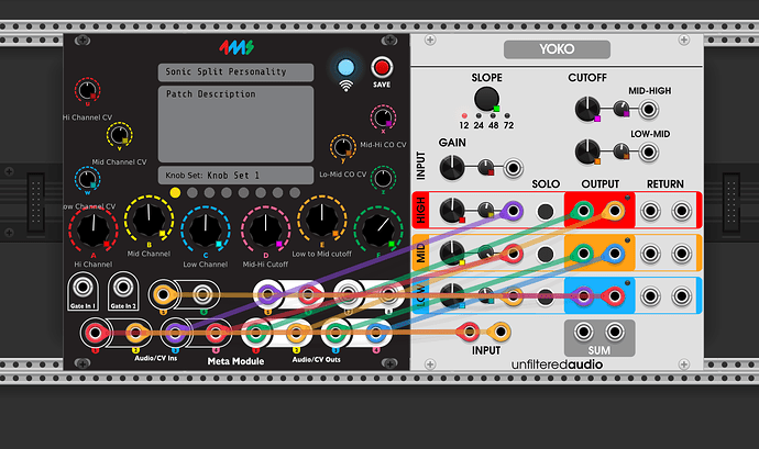

Yoko Frequency Splitter Patch
Will allow you to route each of three frequency bands out to other Eurorack modules. Versions for standard MM as well as an extended one for those with a MetaAIO too.
Oh and make sure you have Unfiltered Audio 2 installed on the MM and the paid for version on VCV if you want to edit the patch there.

This is great! I’m really happy that you’re enjoying it so much.
Two quick ideas for patch hacking:
  1. The Sum outputs would be useful to expose. That way, Yoko can also be used as a quick (if slightly CPU expensive) 3-band EQ.
  2. With the Meta IO Expander, the Return inputs are very useful as you can then route all of your effects back to Yoko to recombine them without an additional mixer.
