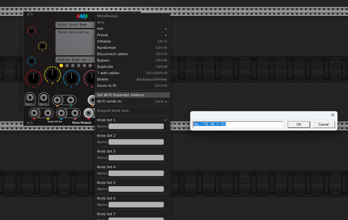

You can also right click on the VCV module and check and reset the address.

Another thing to try is enter in a bad IP address. Make sure the first four numbers are the same, but just change the last number to something between 1 and 255. If you still get an immediate “Failed: no response” then you know the message is not even leaving VCV. On the other hand if you get a 3-5 second delay and then “Failed: no response” then that indicates something is wrong outside of VCV (e.g. the Wifi Expander or router/network)

I get the same immediate response, so it seems right that the message is not leaving VCV. I’ll see if I can figure out why. Any suggestions welcome.
Got it!
I discovered that Stellare makes a module that connects to the internet, so I loaded that into a patch per Dan’s suggestion. Loading it prompted a macOS security dialog saying “Do you want to allow VCV Rack 2 to connect to devices on your local network?” I clicked allow, and that resolved the problem with the MetaModule.

Yeah — if anyone else runs into this issue in the future, I think the fix is Settings > Privacy & Security > Local Network and make sure VCV is turned on.
I just updated the OS on my mac and the problem came back. Went to Settings > Privacy & Security > Local Network and switched “Rack” on and off and it works again. Just to follow up.
