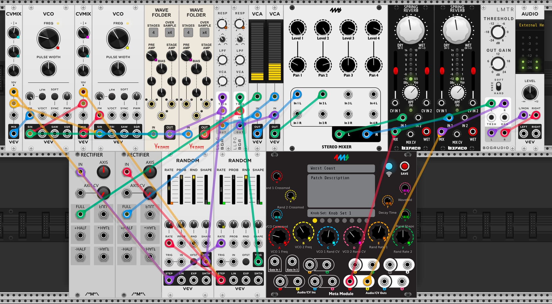

West Coast Patch Video
-Audio main output on ch. 1 and ch. 2
-Two VCOs are entangled with their audio outputs mapped to one another’s FM inputs.
-Each oscillator then goes into its own wavefolder.
-The wavefolder’s both have a dedicated lowpass gate.
-The low pass gates are fed into a VCA for volume modulation
-Each VCA is then sent into a stereo mixer
-The stereo mix feeds into two spring reverb units for Left and Right.
-A limiter is placed on the output for master volume control and clip protection
-Free running random voltage generators are fed into a dedicated CV mixer for each VCO.
-The random voltage amount and crossmodulation are mixed with another to create a 1v/octave signal for the VCOs.
-The trigger outputs of each random voltage generator ping the lowpass gates.
-The random voltages go into a full wave rectifier and are used as CV signals for the two VCAs: this creates random volume fluctuations for each channel.
