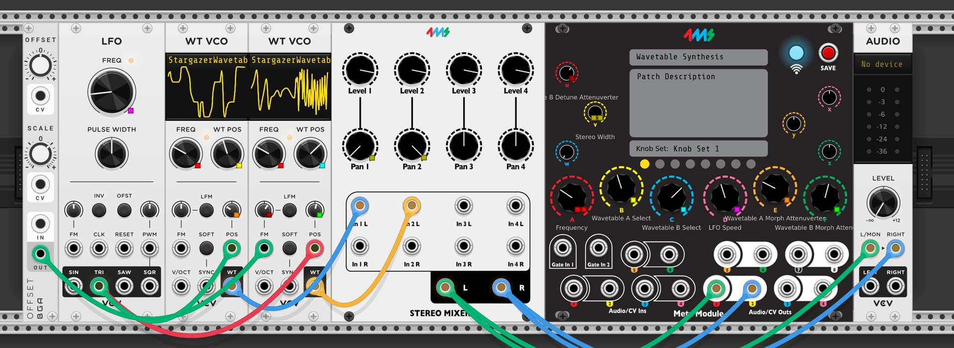

-Two wavetable VCOs are mixed together with a stereo mixer
Internal CV Routing:
-An LFO is fed into the position input of both VCOs
-A very small offset is fed into the FM input of oscillator 2, to be used for slight detuning and frequency beating.
MetaModule Mapping:
A - The frequency for both oscillators
B - Wave selection for the first oscillator
C - Wave selection for the second oscillator
D - LFO speed
E - LFO depth for oscillator A wavetable morph
F - LFO depth for oscillator B wavetable morph
U - Detune amount
V - Stereo width (mono to stereo spread of the two oscillators)
