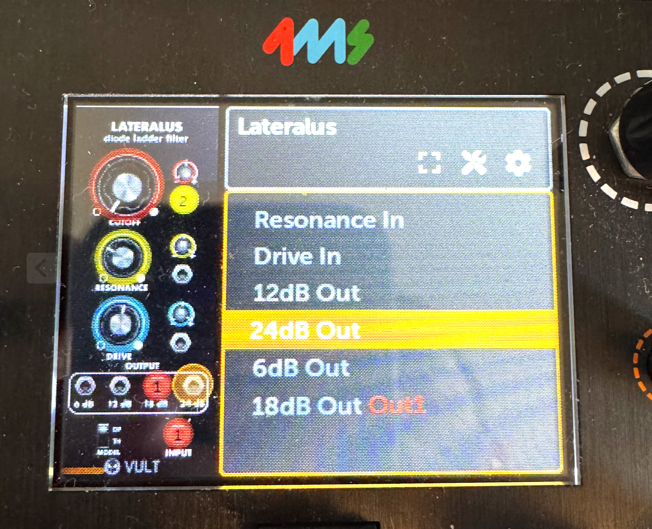

One very small nitpick: The outputs on Lateralus are listed in a weird order, which makes it a bit awkward to find the one you’re looking for. It would make more sense to list them in numerical order, the way they are on the panel.
Unfortunately the order of the jacks has to match the order they are internally coded in the VCV Module enums, so for existing modules there’s no way (yet) to change that without breaking existing VCV Rack patches. That is, if the enum was re-ordered then opening VCV Rack patches created with an earlier version prior to the re-ordering would make the jacks silently be patched wrong
It could be that the order is defined by how the outputs are declared in the code.
the initial version of Lateralus did not have all the outputs. The 6 dB and 12 dB were later additions. I cannot change them in the code, otherwise the VCV patches would break. I would need some way of changing the order without affecting the numbering.
Oh huh. Would it be possible to add a separate enum in an #ifdef METAMODULE block?
Then the patch in VCV wouldn’t match the patch on MM. So if you made a patch with the 12dB Out jack (out jack ID 0) patched to a mixer in VCV then a different jack would be patched to the MM when you opened it there.
The jack ordering can only be set once, before a module is officially released. Once it’s out there, you really shouldn’t change it. This also goes for params.
I think we could support arbitrary ordering of elements on the MM with a small yml or json file in the mmplugin. It could even be part of the plugin-mm.json (OutJackOrder: [2, 0, 4, 1]). But… that’s OT…
