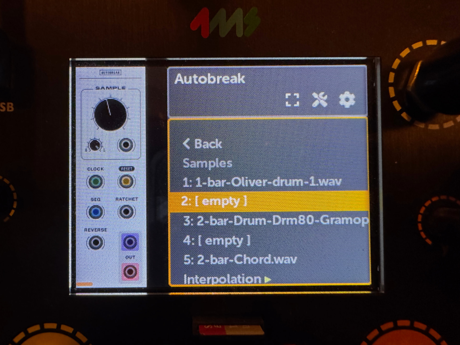

I think the texts are not correctly linked to a function when loading samples in Voxglitch Autobreak and Repeater (firmware 2026-03-09).
Right now I can only load samples into the odd slots. When I click on “Interpolation”, I can also load a sample there. But when I try to load a sample into the even slots, it doesn’t work.
04-Voxglitch-looper.yml (21.3 KB)
This is correct, i think its a 0 vs 1 offset bug between the meta and the plugin. Ghosts is only a single file so you cannot load anything. In your wave player you select slot 2 and it will put the sample in slot 1, and then offset after that, in that case you cant load the last sample…
This should be fixed in the next firmware release, see Loading samples to slots in samplers is "off" by 1 slot - #7 by danngreen
