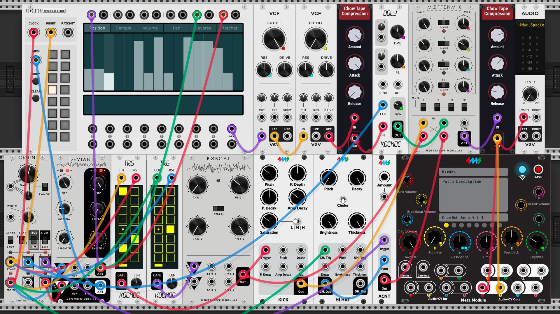

-Main audio outputs on channels 1 and 2.
-Autobreak studio is generating a breakbeat
-Autobreak runs into a resonant lowpass and a resonant highness in series.
-The output of the filters goes into tape compression to glue and squash the beat
-The output of the compressor goes into a tempo sync’d delay line.
-Bobcat, kick, and snare are all mixed together with Autobreak using Moffenmix.
-The output of moffenmix goes into a master tape compressor and then out to the speakers.
-The count is the master clock module and keeps autobreak, deviant, the 3 KocMoc trigger sequencers, accent, and the digital delay line in time with one another.
-Each trigger sequencer controls its own drum.
-Deviant modulates scene selection, sample position, reverse, and ratchet on Autobreak.
Metamodule knob mappings:
A - Lowpass filter cutoff
B - Highpass filter cutoff
C - Resonance for both filters
D - Delay time
E - Delay feedback
F - Delay dry/wet

I think the paths to the x0x modules aren’t working — I get a “This patch includes modules that are not installed” error, and I’ve got the new x0x plugin installed.
Hey Gabriel - sorry about that. This patch was made before the modules were submitted to the VCV library. It should be good to go now - please let me know if you have any issues.
I thought Autobreak studio is not present in MM. It’s not listed in the available plugins!!Only Autobreak.
The files for this post have been updated so that the recommended sample rate and block size of 48k/512 automatically load with the patch. Enjoy! :smiley:
