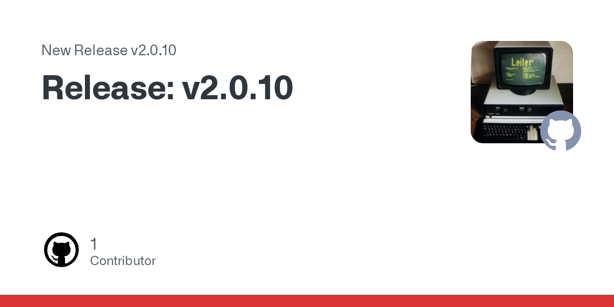

@janne808: a new diode filter, cool! The only thing is that the plugin-mm.json format has been updated. The MetaModuleIncludedModules field now needs to be a dictionary:
I’ll finish the transition from our examples repo to your repo with this release.
Looks good, thanks for that!
I totally missed this but it should be fixed now on v2.0.10:
