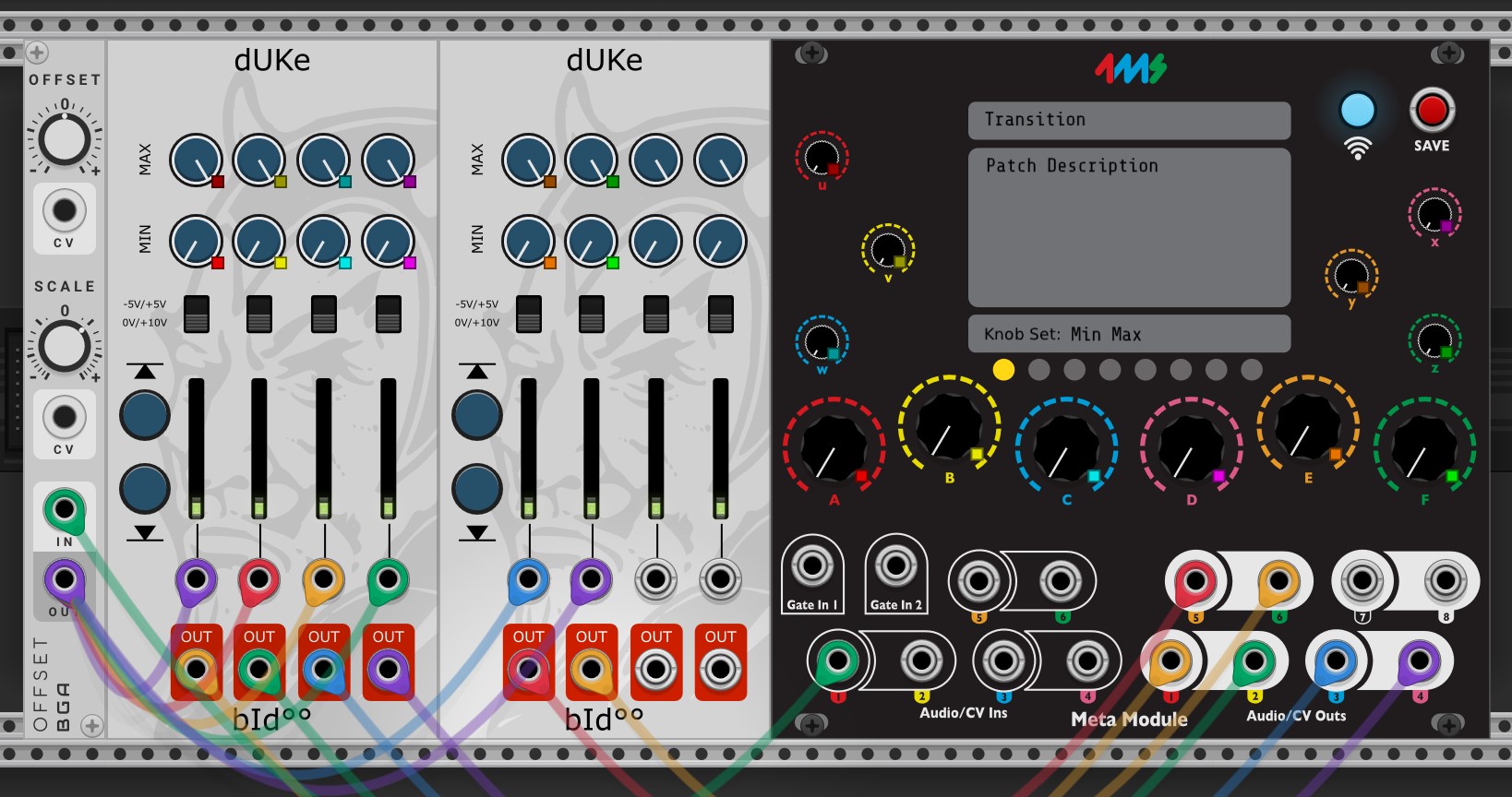

Hi, i created this patch to replicate the Addac Transition module (a fader to connect to multiple destinations, with range modulation knobs).
I would use an external fader to replace the Bogaudio Offset.
The question is: does it works?
I mean Bogaudio Offset is routed to multiple Duke input. Is it allowed in 4msMM?
Thanks
You can download the patch.
2 sets of knobs: First set is to controll the min max, second set to controll the range.
External offset to controll multiple destinations.
