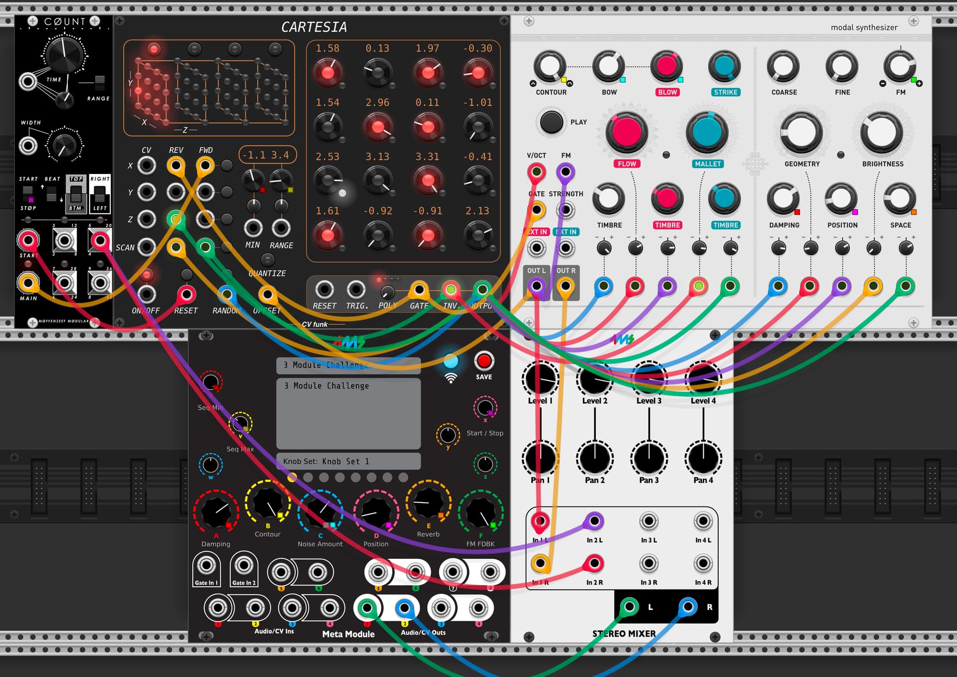

Three Module Challenge
-Main audio output on channel 1 and 2
-A 1/4 note pulse from Count and the stereo output from the Modal Synthesizer are sent to the main outs
-CV Outs from Cartesia are fed to the 1v per octave input on the Modal synth
-CV Outs from Cartesian are fed back into itself in chaotic ways to enhance a pseudo random output
-The start output from count is resetting Cartesia so that the pulse and the rest of the patch always stay locked rhythmically.
-The output of the modal synthesizer is fed back into itself via the FM input for feedback.
Metamodule Knob Mapping:
A- Damping
B - Contour
C - Noise Amount
D - Position
E - Reverb
F - FM Feedback
U - Sequence minimum
V - Sequencer maximum
