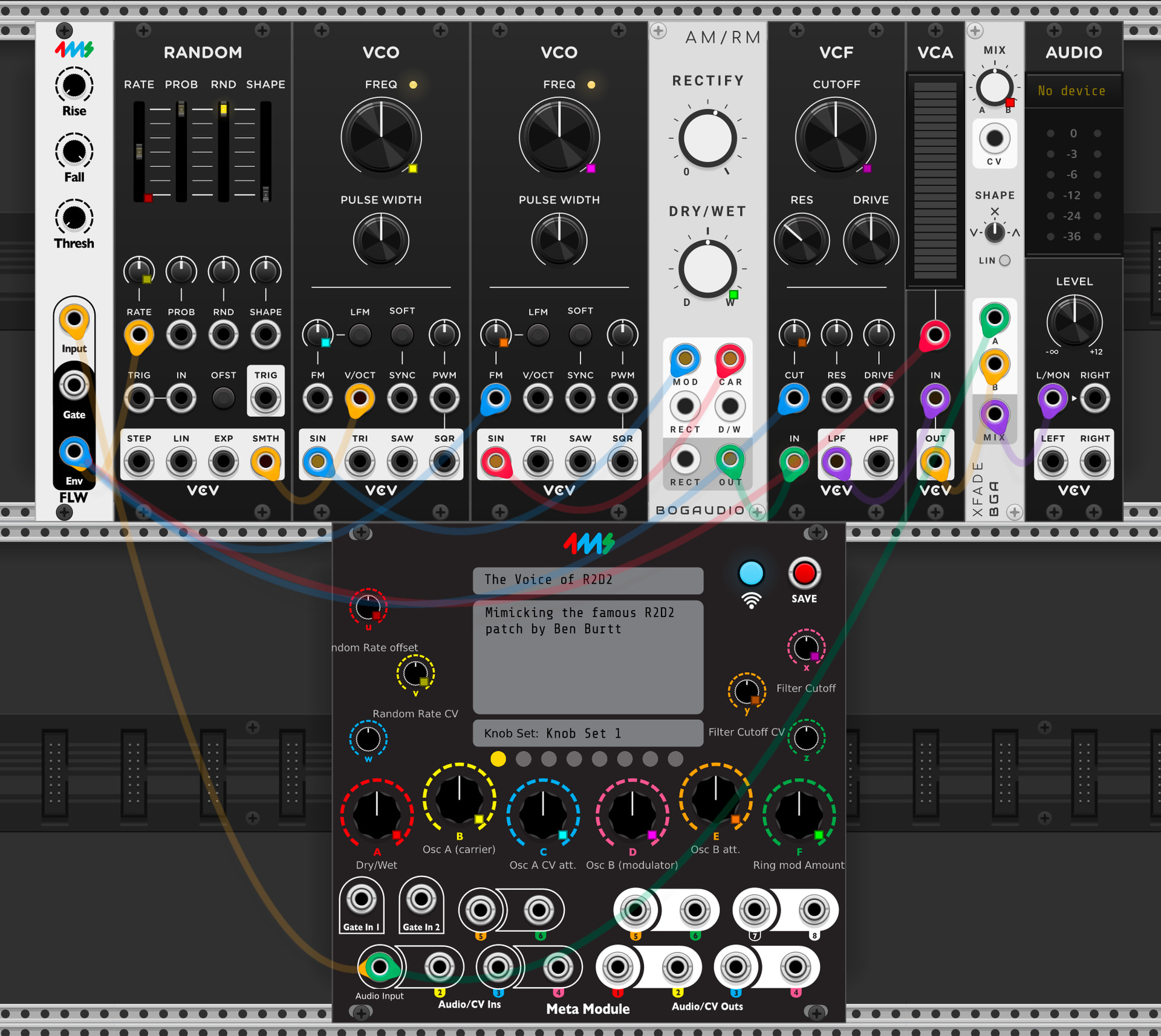

NOTE: For this patch to work you need to run line level in or use an external Mic preamp. You cannot plug a microphone directly into MetaModule. The volume of the microphone directly affects the response of the patch, in combination with the envelope follower release time.
External Audio Routing:
-Main outputs on channels 1 and 2
-Microphone input on channel 1
Internal Audio Routing:
-The microphone input is ran into an envelope follower
-Two oscillators are mixed together into a ring modulator
-The ring modulator is fed into a lowpass filter
-The output of the lowpass filter is fed into a VCA
Internal CV Routing:
-A stepped random voltage modulates the modulator of the Ring Mod
-The carrier of the ring modulator is directly modulated by the envelope follower
-The cutoff of the filter is modulated by the output of the envelope follower
-The overall volume of the patch is driven by the envelope follower
MetaModule Knob Mapping:
A - Global Dry/Wet
B - Oscillator A (Carrier)
C - Oscillator A CV attenuator
D - Oscillator B (Modulator)
E - Oscillator B CV attenuator
F - Ring mod amount
U - Random rate offset
V - Random rate CV
X - Filter Cutoff
Y - Filter Cutoff CV
