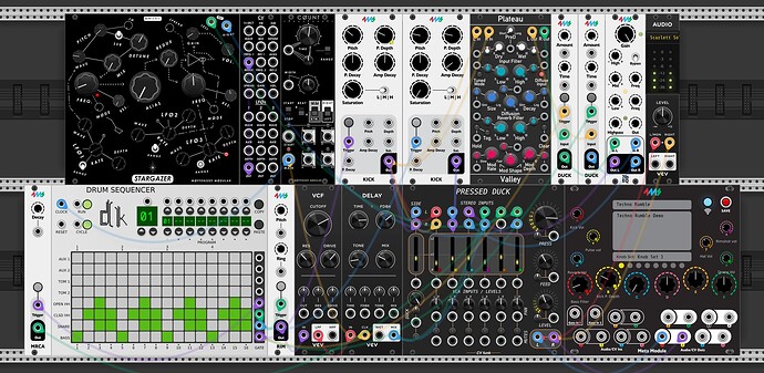

Techno Rumble Patch
You can watch the video for Techno Rumble here.
External Audio Routing:
Internal Audio Routing:
-A kick drum is fed into a plate reverb
-The plate reverb is ran into two Duck modules
-The output of the Duck modules are processed with the 70s EQ
-The 70s EQ is sent to the Pressed Duck which mixes all the signals together
-A secondary Kick, Stargazer, and Maraca are also sent to the Pressed Duck
-A Rimshot is lowpass filtered and then processed with a delay line before being sent to the Pressed Duck
Internal Logic Routing:
-The Count is a master clock source for the Drum Sequencer and the delay line for the Rimshot.
-Outputs from the Drum Sequencer trigger all of the drums
Metamodule Knob Mappings:
A- Bass filter - Stargazer lowpass
B- Kick P. Depth
U- Kick volume
V- Pulse volume - secondary kick
W- Reverb volume
X- Rimshot volume
Y- Hat volume - Maraca
Z- Drone volume - Stargazer

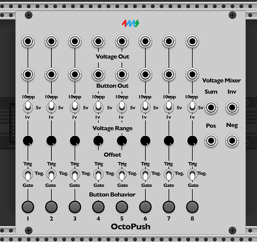

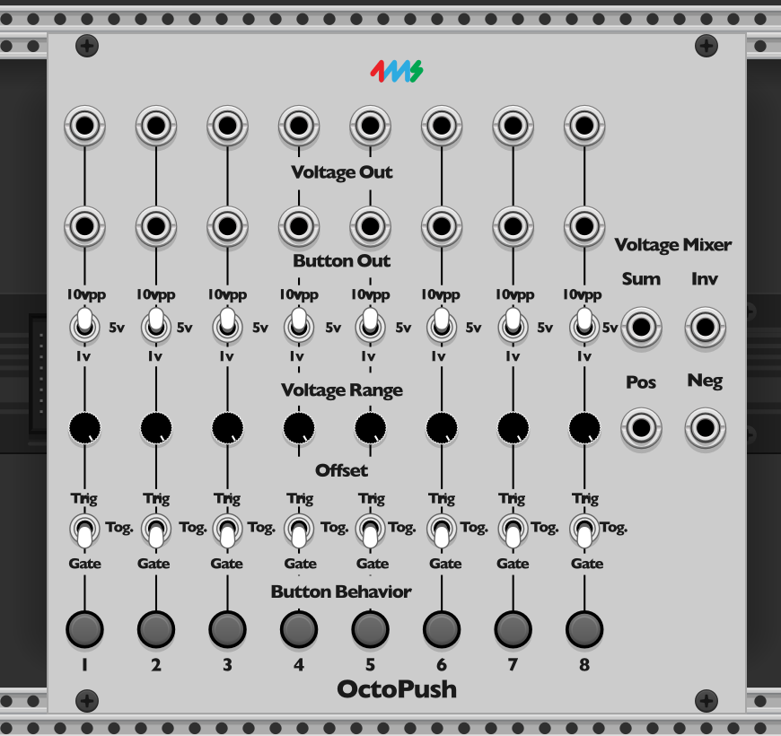

I’m actually designing a 1x8 version of something like this currently for usage with meta buttons, but maybe there’s a feature set that’s better suited for this preset type of behavior. Are there any specific things you wish it did? Might be something worth adding to the VCV and meta library.
(this is an screenshot of the ugly WIP panel for dev for the forthcoming octopush)
The octopush thing I’m talking about below would give you what you wanted if there was a multi-column sequencer that had a CV input for active step rather than just a clock to advance the next step.
Again, the Count Modula 8-Step (and 16-Step and 64-Step) all do that — if you need multiple columns you could sync multiple sequencers to the same voltage input.
The OctoPush is a fantastic idea and makes me want a button expander for the first time.

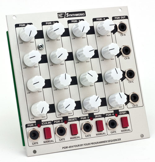

I used to make Eurorack modules under the name Synthwerks, We made a programmer/sequencer, the PGM-4, which is what you are looking for. Anyone can make one of these for VCV, if I had programming chops, I would myself.
Hopefully with the new expansion modules finally out there, some new modules will be designed that truly exploit them. A programmer like the one shown above could easily take advantage of the pushbutton module (and future pot expander modules).

Oh cool! I know Synthwerks, right on man. Yea this is type of thing is exactly what I was thinking just with 8 knobs per column and clocking abilities + voltage addressing so it can double as a sequencer. I might also toss in the button behavior switch from Octopush so people can do gates, trigs, or toggles with each button. Octopush and Solopush are forthcoming as part of a pack I’m putting together called ButtonUtilities. If anyone has any other stuff they wish buttons could do please feel free to let me know and I’ll put something together.

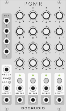

There is the Bogaudio PGMR which I think may do what you describe:
Man, that is about as close as you can get to the PGM-4X4. The PGM-4X4 could be linked to another and do what the adding the PGMRX can to this module.
Looks like that’s the ticket!
