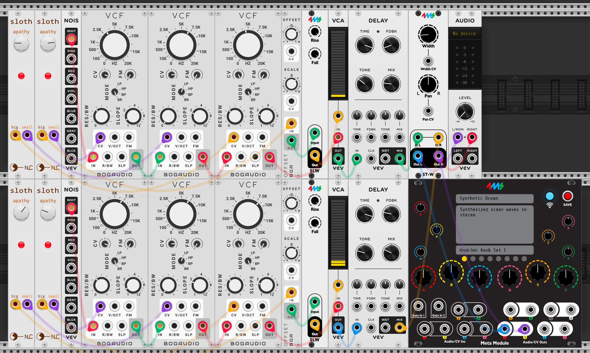

External Audio Routing:
Internal Audio Routing:
-There are two identical signal paths
-White noise is ran into a notch filter, then a lowpass, then a secondary notch filter
-The final notch filter’s output is fed into a VCA
-The output of the VCA is routed to a delay line
-Each delay line’s output runs into a Stereo Width module
Internal CV Routing:
-Outputs from two Sloths control the cutoffs of all of the filters
-One of the Sloth’s outputs is offset so that it always remains positive and then is slewed
-The output of this slewed signal is fed into the CV input of the VCA to control the volume of the ocean waves
