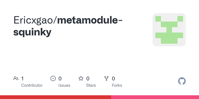

Squinky Labs Ported
Everything here: VCV Library
But no compII (it’s just a polyphonic compressor so not like you can even use more than one channel on MM)
No seq, as the UI doesn’t make sense for MM
No SFZ player (TBD, this would be cool, but will take some time to compile)
This is probably one of my biggest ports yet, requiring some net new UI/UX to be built for many of the plugins. A lot of the Squinky stuff has drop down menus, which unfortunately aren’t knob assignable - you’ll have to assign those manually on the MM once you port it from VCV - but after that it should work well!
I added labels to show you what the value of those drop down menus are as well.
Definitely try Stairway filt, it sounds really good with many topologies.
