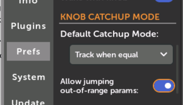

I just implemented a quick solution that adds a user option to the preferences pane:
When checked (default), moving the panel knob to the closest position to the out-of-range parameter will automatically “pickup” the param and start tracking it. So this works with the Push patch, probably how it was intended to work (and I tested for inverted and non-inverted Min/Max values).
When not checked (no jumping), a notification pops up when you move the knob to the farthest extreme (100% or 0%, whichever is closer to the param). The notification could get annoying if somehow you really want it to behave this way, so I’m considering a third option for “Do not allow jumping but don’t notify”… Or we could notify just once until you open the patch again. Though, if someone doesn’t read and fully comprehend the notice it won’t be clear how to get it to show up again.
Any feedback on this is welcome, I’m calling it “v2.0.0-dev-12.10-rc1” because I’m not sure this is the right direction or not.
just tried this out and it seems to be working great with my button/knob dual mapping. ty!
im curious what kind of cases there would be where users would want to map a knob and button but not want the button to be able to work with track when equal (i can’t think of any). the notification was intensely repetitive but i would think, better to have it there so users would fix the issue or they just turn on 'allow jumping out of range params"?

upon further investigation of the new ‘allow jumping out of range param’ feature, im noticing that if you start the patch with the mm physical knobs at 0 (and the default of whatever those are mapped to in the patch is 0 at startup), you will need to first turn the knob >0 and then back down to zero for it to catch. one would expect the jump to occur right when you turn the knob, instead of having to initially turn it up then down, then turn it up again for it to work. im curious is this intended behavior?
quick test patch demonstrating (u knob)
- param jump quick test.yml (2.2 KB)
I see… I think it just needs to be allowed to jump an out-of-range parameter when the knobset or patch is first loaded (instead of only when the panel knob is moved)
I just fixed it, seems to work now with that patch.

awesome, seems to be working ok w 12.13!
