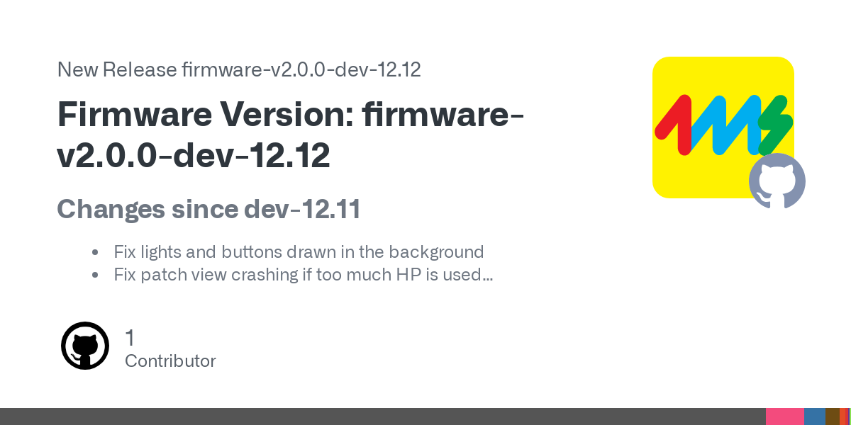

Here’s the fix:
verified, the patches are working again, ty dan!
