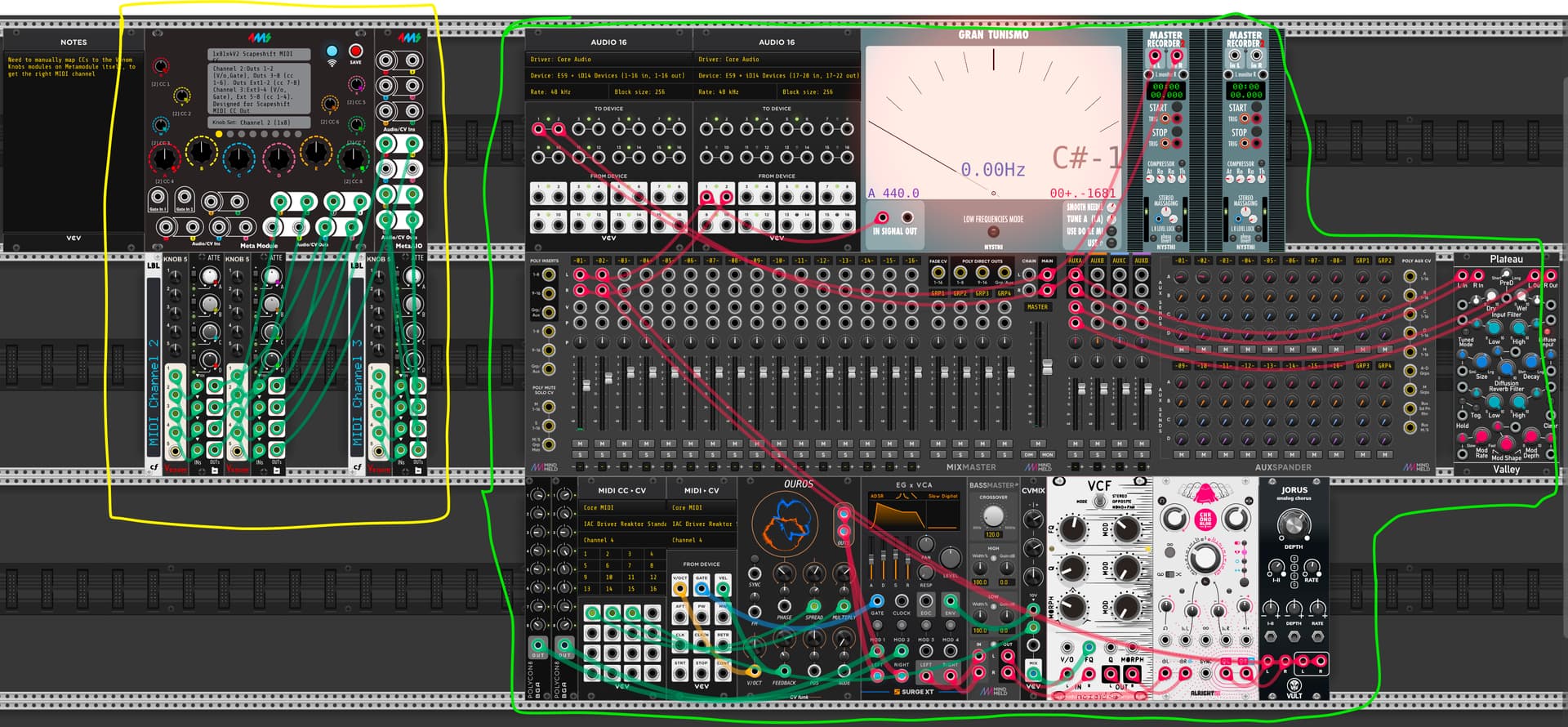

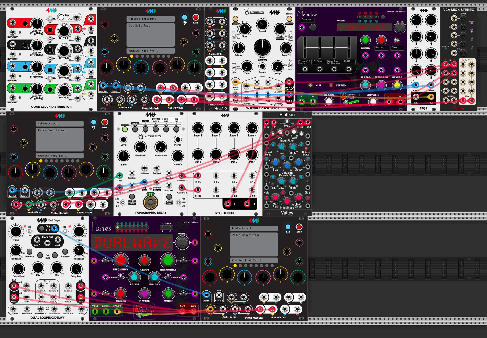

I would like to be able to work on building Metamodule patches in VCVRack and also run an FX & mixing VCVRack patch at the same time to process the audio coming back from my Eurorack case. I could then iterate on the MM patch (using the Wifi expander) + the Eurorack + the final end-of-chain VCVrack FX & mixing all at the same time.
The Problem
This is not possible at the moment afaik, because the VCVrack Metamodule will include all (well, most) modules from the VCVRack patch (including the FX + mixing module section) in the exported vcv patch.
In the example below, the yellow section is the Metamodule patch, and the green section is the post-Eurorack FX + mixing section. Note that it just happens that the FX section contains some modules (e.g. Valley Plateau, because reverb is life) that also exist on the MM (and so would not be automatically “ignored” when loaded onto the MM)
1x8-1x4V2-Scapeshift MIDI audio mix.vcv (8.5 KB)

Another idea to consider, at some point I thought it would be nice to scan all the cables and determine if a module is patched, directly or indirectly, to the MetaModule hub that you clicked “Save” on. That should produce the same result in your screenshot at least, since all the modules in the yellow box have a cable that eventually reaches the hub, and all the modules in the green box do not.

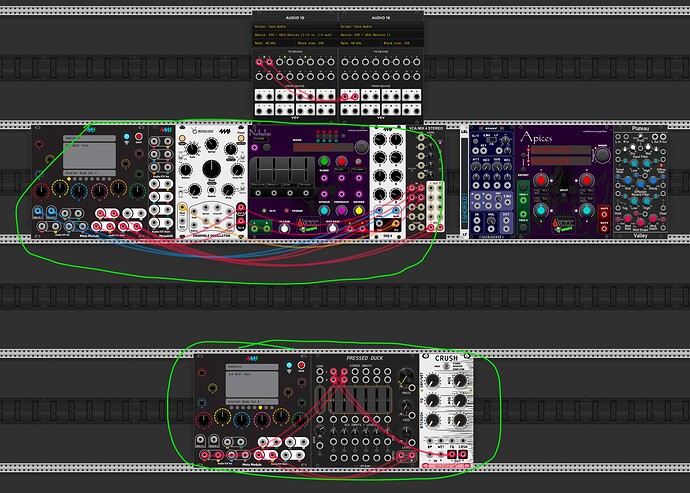

Hi @danngreen I know you guys are in Superbooth this week, but here’s something to look at when you return to base … Selectively ignore modules when exporting a yml patch file by rjsmith · Pull Request #39 · 4ms/4ms-vcv · GitHub

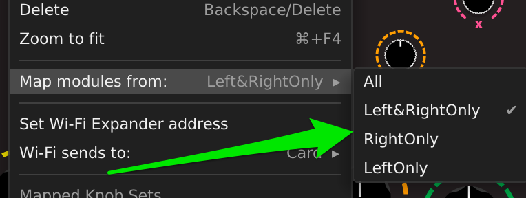

The PR adds three new module selection modes in a context menu that only select modules directly placed in a line next to a Hub module (in the same way as the Stoermelder Strip module works, Left&Right, Left Only or Right Only).
As a side benefit, it also allows one VCVRack patch to have multiple Hub modules that export different attached module chains (each Hub module instance can have a different module selection mode).

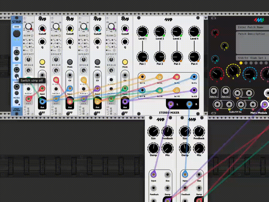

Strip Module-1
Yeah,I’ve already been using the Strip module to save a MM module chain (with a hub module) as a selection, so can paste it into other .vcv racks.
And to mash the Strip’s randomise button then ping it over to the MM ! The Strip is ignored by the MM of course (although u do see that warning on the module, wonder if there is a way to suppress that?).
Yeah, I have wished for a way to whitelist utility modules that I always use in VCV to prevent that warning from appearing on the Meta. This “right/left only“ feature would solve that, although maybe not for Strip if you use that.

Ok, this is merged into the main branch of the 4ms-vcv plugin. It’ll be in the v2.0.15 release.
Thanks @phommed for this!
Also now that this module filtering framework is setup, I added a fourth option: “Connected”, which only adds modules which are connected by cables to Hub, directly or indirectly. This includes modules that are connected to a module that’s connected to a module that’s connected to a module…etc etc… to a module that’s connected to the Hub.
