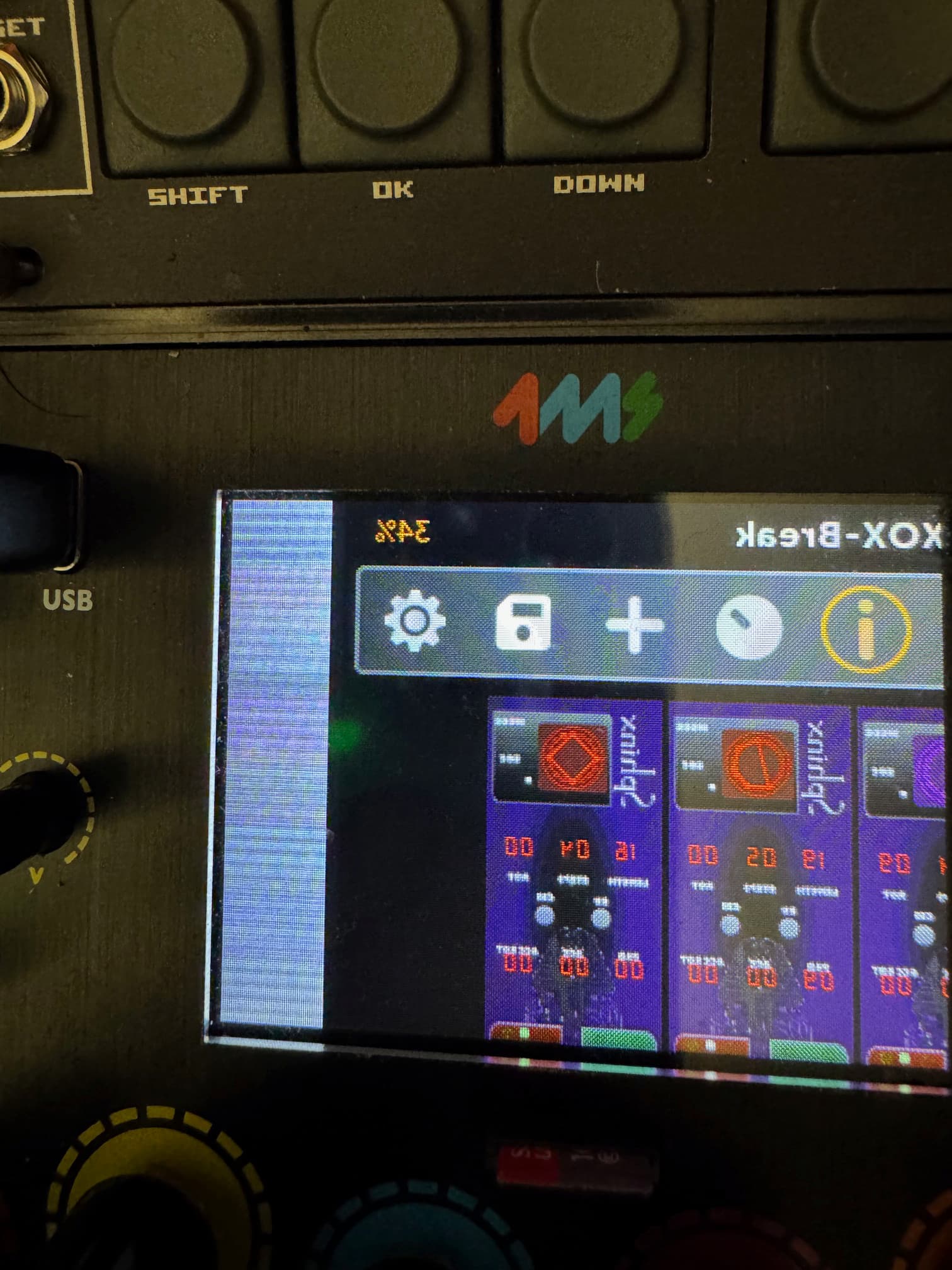

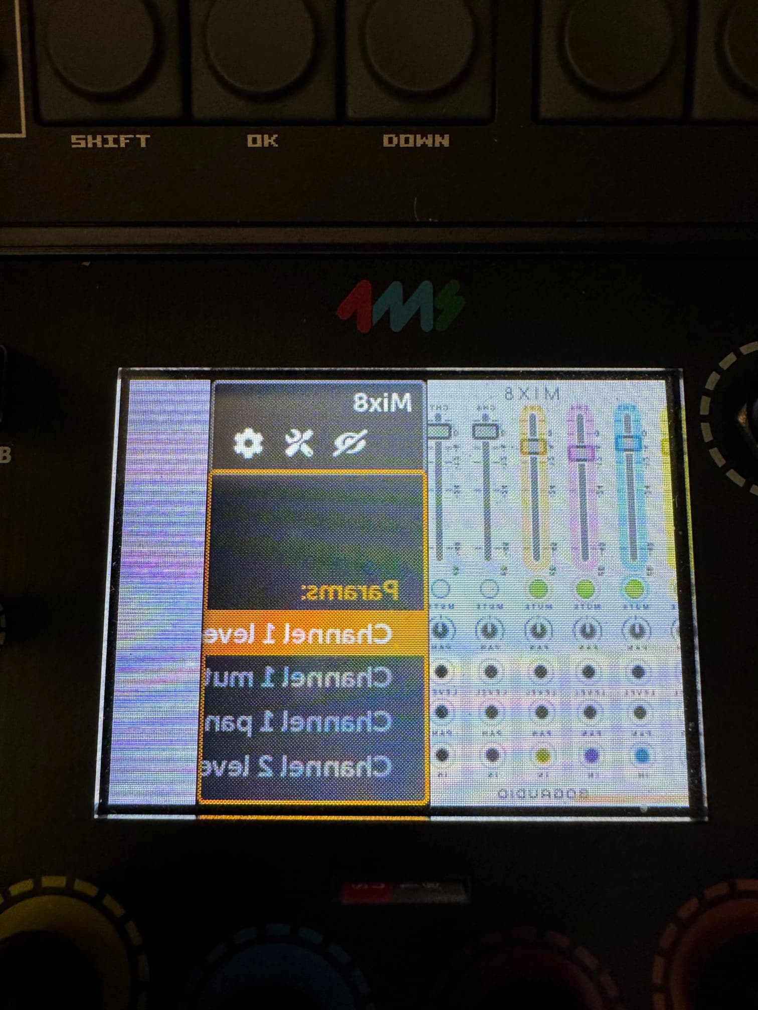

I am using the v2.02 of the Firmware, and the screen has becomed mirrored, as per the image. The weird thing is that everything is still working fine, just the screen issues. I have also experienced the screen turning white issue reported here - [Updated to v2.0.2 and now white screen and nothing works (edit: seems okay now)](https://Screen turning white issue)
Reboot fixes things. It seems to happen when I leave a groove running for a hours, which I often do, as I am working throughout the day, every so often I will work on my gear then mute, do some work, then come back to later.
Could that be a loose cable?
Woah.. I have never seen that!
Yes, I would think this is a display cable issue, if the cable clamp is not all the way closed, then when it warms after an hour or so, it stops making a good connection? You can re-seat the cable in its slot, it’s easy to do but requires removing the faceplate. Email us and we can help walk you through it (or we can arrange for you to mail it back and we’ll do it)
