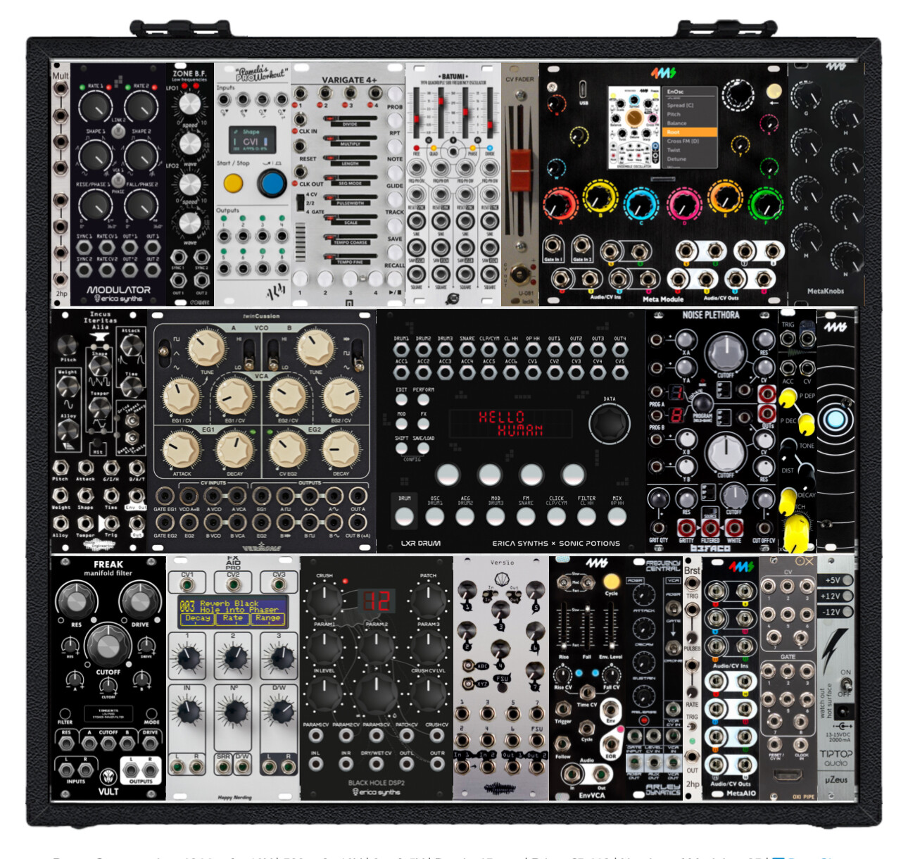

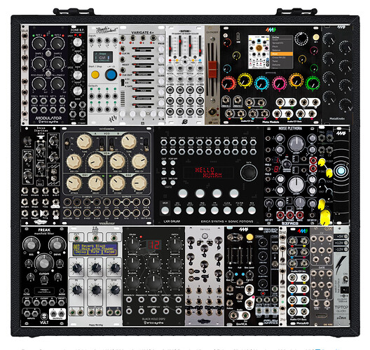

Quick question on I/O module cable length
Ideally would like to place it a couple of rows down - would this work?
My meta module ribbon expander cable only allows it to be either side or maybe one row up or down directly above or below meta module.

Thanks - good to know, think I’ll need to swap a few things around…

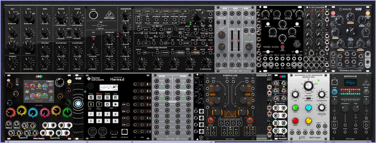

I’ve tried to route mine
but had trouble, will it help to wrap the ribbon on a torroid? The hermod probably has some noise…
I need to have i/o closer to ensemble.
I have attached a longer cable, wrapped with snap on torroid - I was hearing clock noise.
Meta detects I/O board.
I have a ensemble out directly wired to 9 however nothing is coming out of output 9. Is there something special about the included cable?
This setup works with included cable, just not my longer one (tried 2 different cables).
