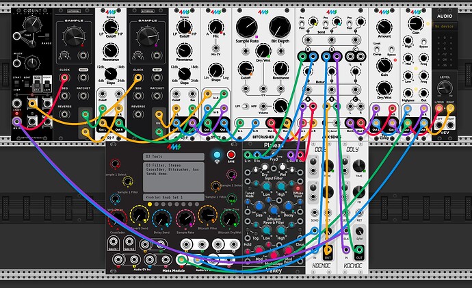

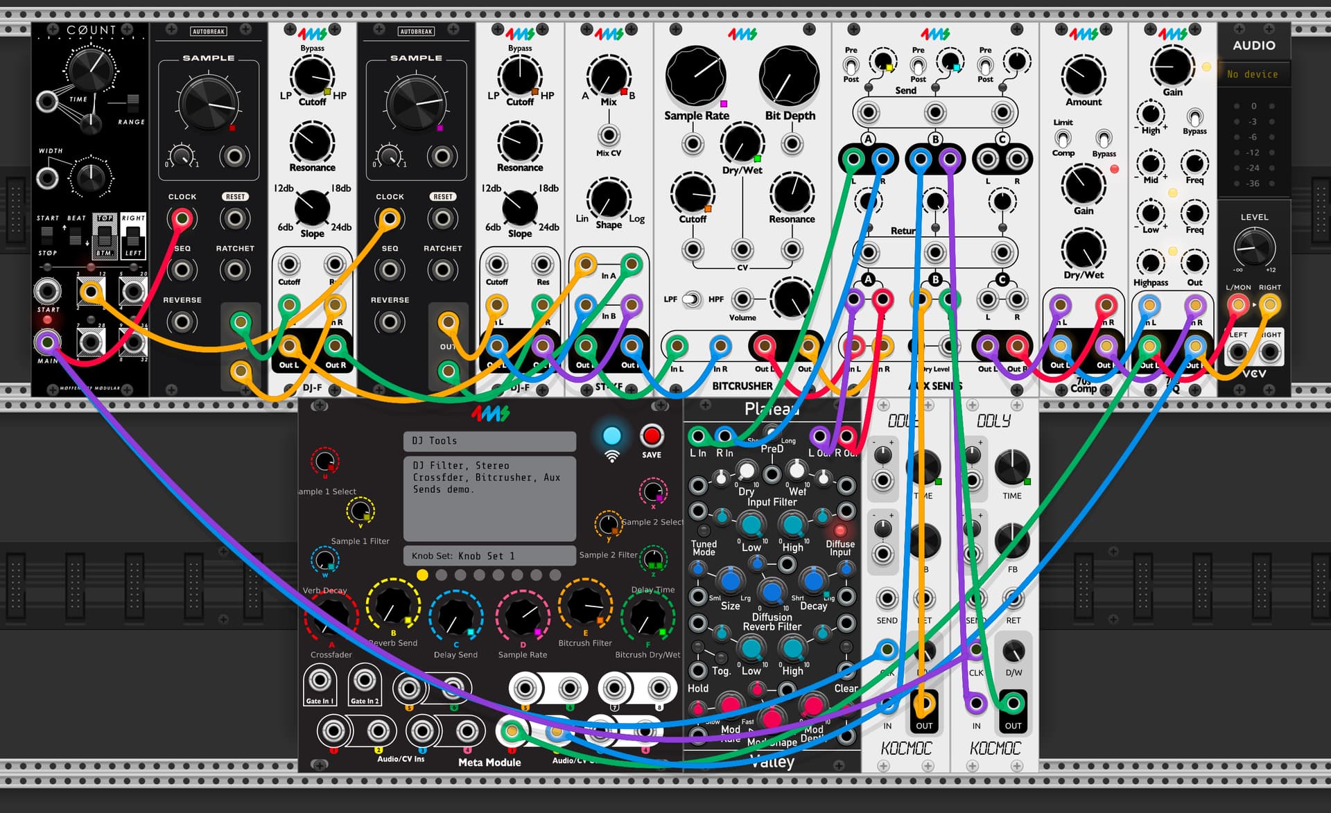

External Audio Routing:
Internal Audio Routing:
-Two samplers are fed into their own DJ mixers
-The two DJ mixers are fed into the stereo crossfader
-The stereo crossfader runs into the Bitcrusher
-The Bitcrusher goes into Aux Sends
-Aux sends goes into 70s Comp
-70s Comp goes into 70s EQ
-70s EQ goes to the main outputs
-Aux send loop 1 goes to Valley Plateau for reverb
-Aux send loop 2 goes to two KOCMOC delays for delay
Internal CV Routing:
-A 16th note pulse from Count clocks Sampler 1 and both delay lines
-An 8th note pulse clocks Sampler 2 for half tempo/pitch
MetaModule Knob Mapping:
A - Crossfader
B - Reverb Send
C - Delay Send
D - Sample Rate
E - Bitcrusher Filter
F - Bitcrusher dry/wet
U - Sample 1 select
V - Sample 1 filter
W - Reverb decay time
X - Sample 2 select
Y - Sample 2 filter
Z - Delay time
