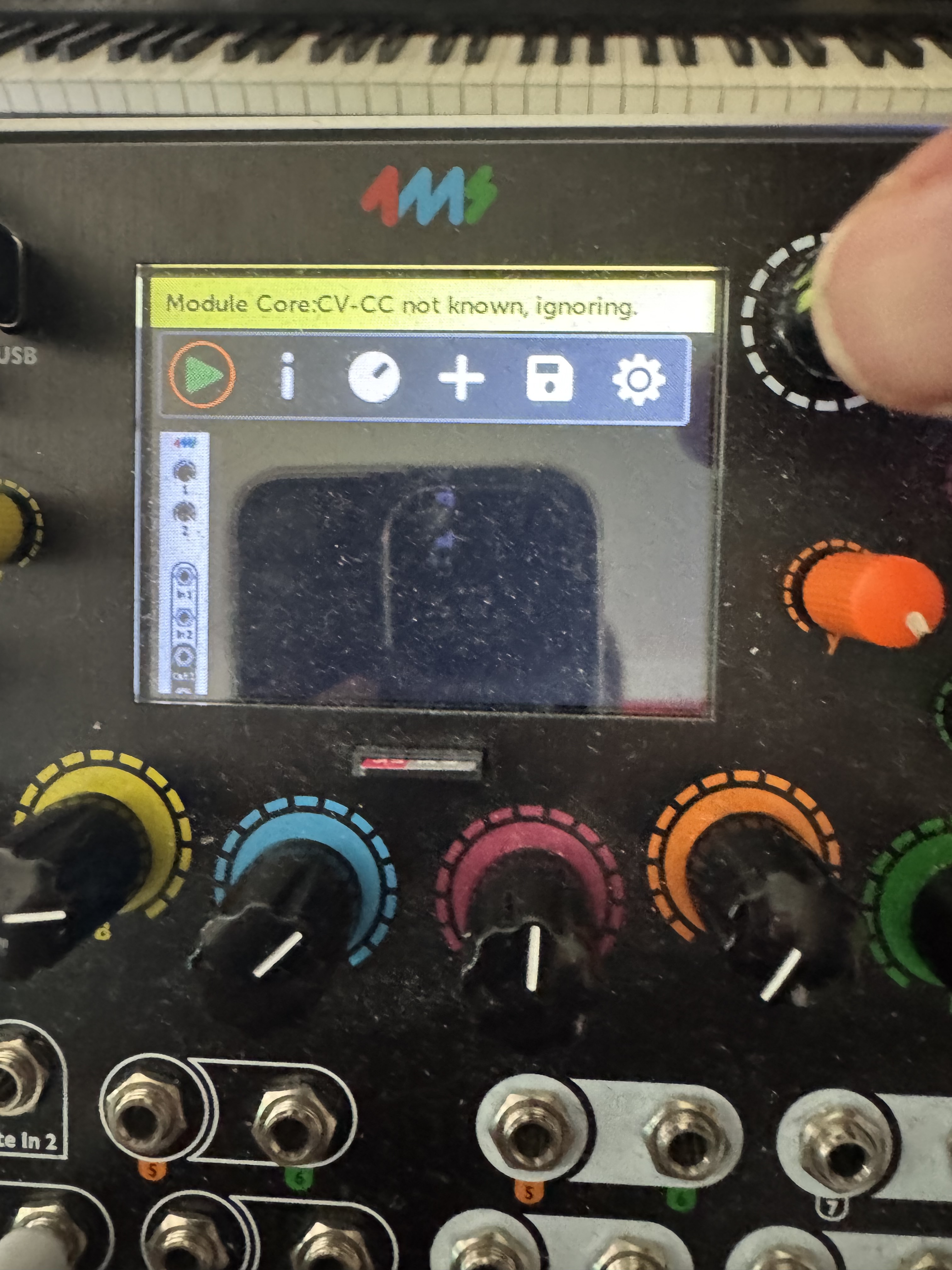

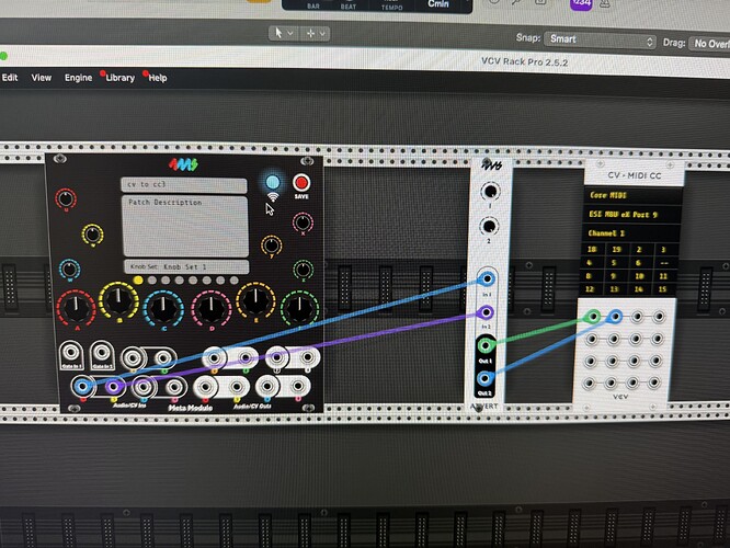

quick question i recently saw the vid where 4ms made a patch utilizing midi cc to cv but can we do the inverse? use the cv to midi cc module and send cv from out rack through the inputs and to something like my eventide pedals .. loading the patch in meta it doesn’t work and says that cv to midi cc module ignored
Yeah - doesn’t look like that CV to CC module is working yet.
