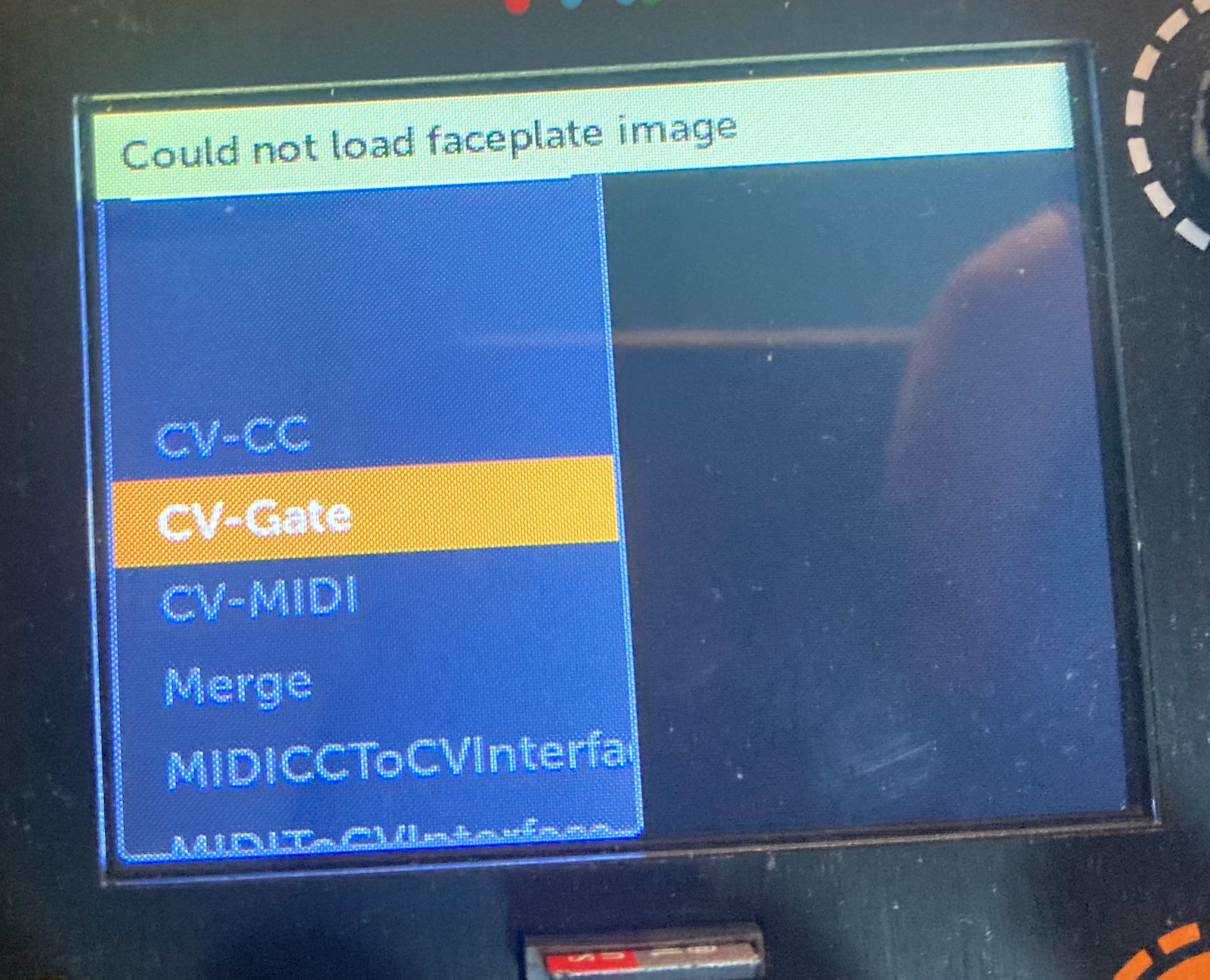

Hi Dan, I downloaded the latest plugins from (https://metamodule.info/plugins), but it seems like Faceplate under the RackCore project didn’t get packaged successfully…? thank you !!
Did you update the firmware using the link from the Downloads page?
The CV-Gate module lives in the firmware, not in the plugins (RackCore is a built-in plugin).
And the faceplate images themselves are in the assets image, so if you updated firmware by compiling it yourself, or by going to our github releases page and downloading a release file, then you have to make sure you also update the assets image. You can do this by using any of the release files that have “assets” in the name.
I would just recommend the easy route and use the link on the Downloads page:
https://github.com/4ms/metamodule/releases/download/firmware-v2.2.0/metamodule-firmware-v2.2.0-firmware-assets.zip
That will update firmware and the assets all in one go.
yes… I performed the firmware-v2.2.0 upgrade using the official download page… :face_with_spiral_eyes: Neither the firmware nor the plugin was obtained through GitHub, and no unusual messages appeared during the firmware update process… But I’ll try again tonight. Thank you.
After updating it again, it’s working normally now :joy: , thanks Dan!
Ok, great! I have that happen all the time to me when I test various firmwares and forget to use the assets file.
But it could also happen if for some reason the update of the assets had an error when you originally updated.
In any case, glad it’s working
