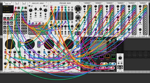

This patch is a polyphonic MIDI Ouros Patch.
4-channels of polyphony trigger AD gates and output through a Pressed Duck Mixer.
You can input a side-chain to Inputs 1/2, and the side-chain envelope to Input 3.
Input 4 maps to the FM of all the Ouros modules.
Gate 1 maps to the Sync of all the Ouros modules.
Now there are a few control layers.
Ouros Layer
Knobs 1-6 map to the main Ouros knobs.
The smaller trimpot knobs map to Range modules that set the spread of the params on the 4 Ouros layers. It’s a lot of wires.. but this makes it easier to set up a span of poly voices.
Mixer Layer
Knob 1 sets the Side-Chain level, and 2-5 set the 4 Ouros channels. 6 sets the master vol.
Envelope Layer
Knobs 1-4 set the Width Shape Slant knobs
Requires the latest CVfunk build.
Runs very stable at 32k/64
