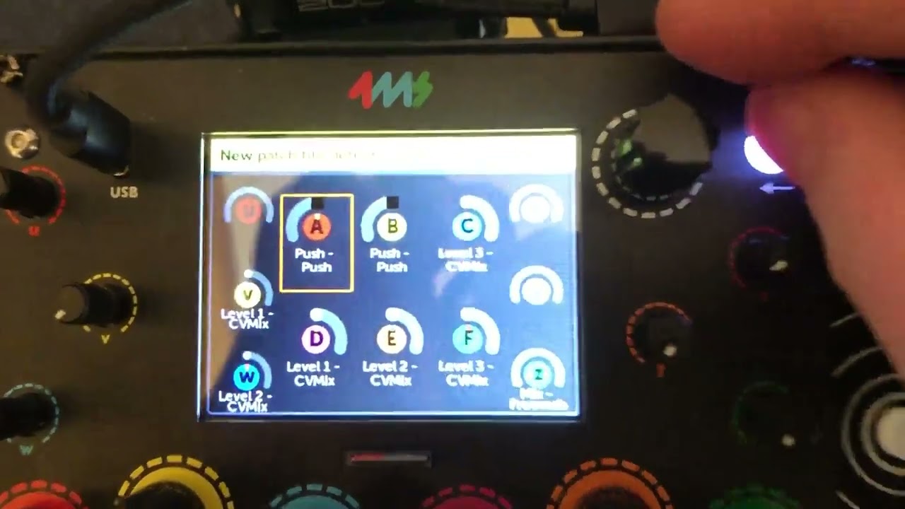

happening with the patch below:
8x sample loop player.yml (18.9 KB)
maybe something to do with these patches that need to push a lot of stuff into ram (i.e. takes a while to load)?
can send the samples i used in the patch (or the ones i send for our previous load patch crashing issue would work as well)
              This is with dev-12.11? or 12.12?
              sorry, this was w firmware 12.12
              OK, I’m trying to replicate this using the large samples from before.
Does this pop up as soon as you hit Play? Or does it pop up when you actually send an updated patch file via Wifi? Or at some other time?
              it seems to only have happened when the patch was updated via usb (via kvm switch, not wifi due to needing to also transfer/edit .wavs constantly).
also if im remembering, i don’t believe the patch was actually playing when the refresh occurred. i can’t tell exactly, looking back at the video as the cpu% is covered by the message but the module view ui frame rate is responsive enough that im pretty sure the patch wasn’t playing.
