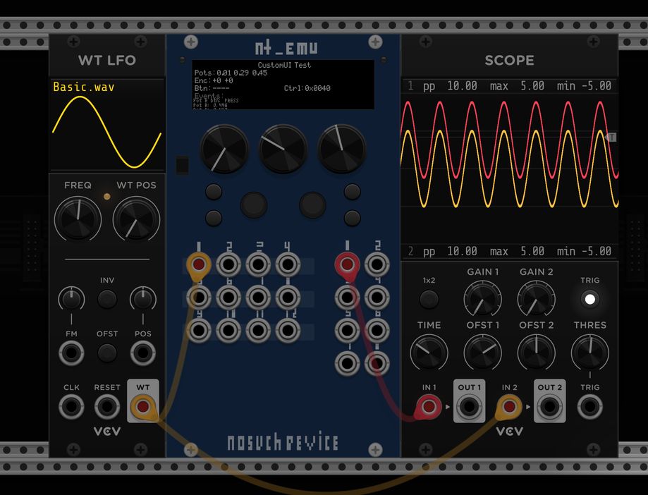

The developer of the “NT Helper” app has recently shown an early version of a Disting NT emulator module for VCV. With that we might be only one step away from running an instance of the Disting NT inside the MM! I say that with my tongue planted firmly in my cheek as there would likely be issues of whether the MM would have sufficient processing power to run such a module.
Edited to add that the VCV module shown is intended by the creator as a development platform for his user created apps and it would not not likely be able to run the native Disting NT algorithms.
