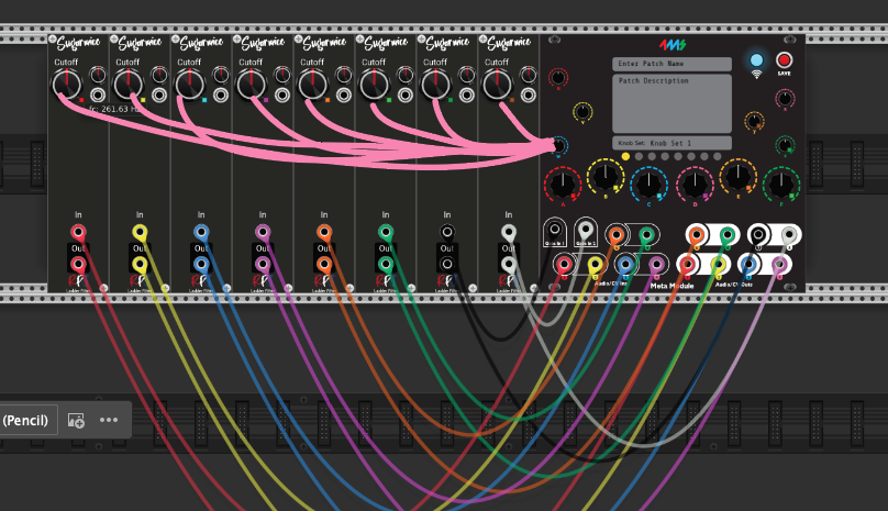

hmm, maybe I’m reading wrong, but I can’t get this to work, I’m trying to map multiple knobs to one parameter and it still deletes the previous mapping.
specifically: If I want to have individual control over 8 filters, but then have one macro knob control them all at once, is this possible with just a click that I’m not understanding? (as noted above, it seems possible by editing code or doing it in hardware, but if I can do in VCV easily that would be neat)
for more clarity: Marked in pink thick lines is the mapping I want to do
You can map a single MetaModule knob to a maximum of 8 virtual module knobs. So the pink lines in your screen shot should work.
But – I also notice in your screenshot that those 8 knobs are mapped to panel knobs A-F and y and z. You can’t have those mapped AND the pink line mappings at the same time.
ah, gotcha, that’s exactly what I wanted to do.
Multiple meta knobs to the same virtual knob.
(I do understand it’s maybe a strange desire though, I’m just experimenting, and thought it would be fun to be able to do that!)
(I also mis-spoke above, I don’t think it’s possible in the hardware either, right? I tried, and it didn’t seem possible)

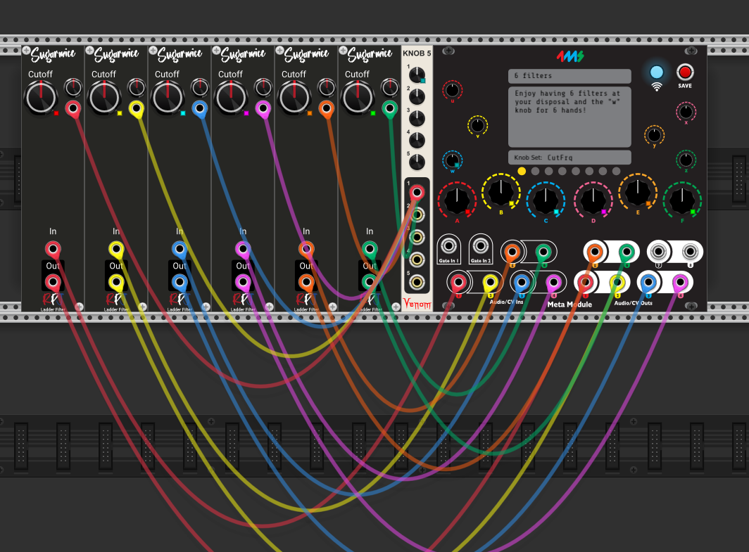

In your 8x filter patch, you could try multing CV from another knob module (e.g. Venom Knob 5) to the cutoff CV inputs on your filter modules (then set the CV amount knobs on each accordingly), then map one MM hub knob to the Venom knob.
Thanks! @phommed I’ll try the next time I get to the studio! I’m pretty new to all this stuff and I can imagine something like what you say is “possible” just not totally fluent in this new language of which parts do what :sweat_smile:
I’m reading “patch at tweak” though and it’s helping a ton and especially all the help on forums like this. :raising_hands:
huzzah! it works! Thanks everyone!
I put attenuation knobs on the 2nd knobset, (otherwise the CV wouldn’t work)
now to add some more complexity, but understanding this basic concept opens door for me, THANKS!
