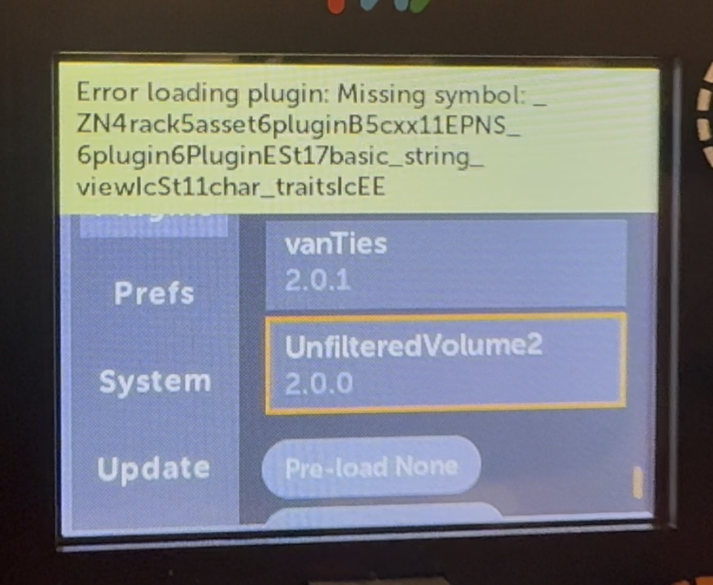

first error, when i try to load all plugins, plugins that i just downloaded using the main plugins link from the website.

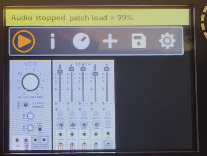

second error message, when i try to load the horror / cc patch from the patch gallery

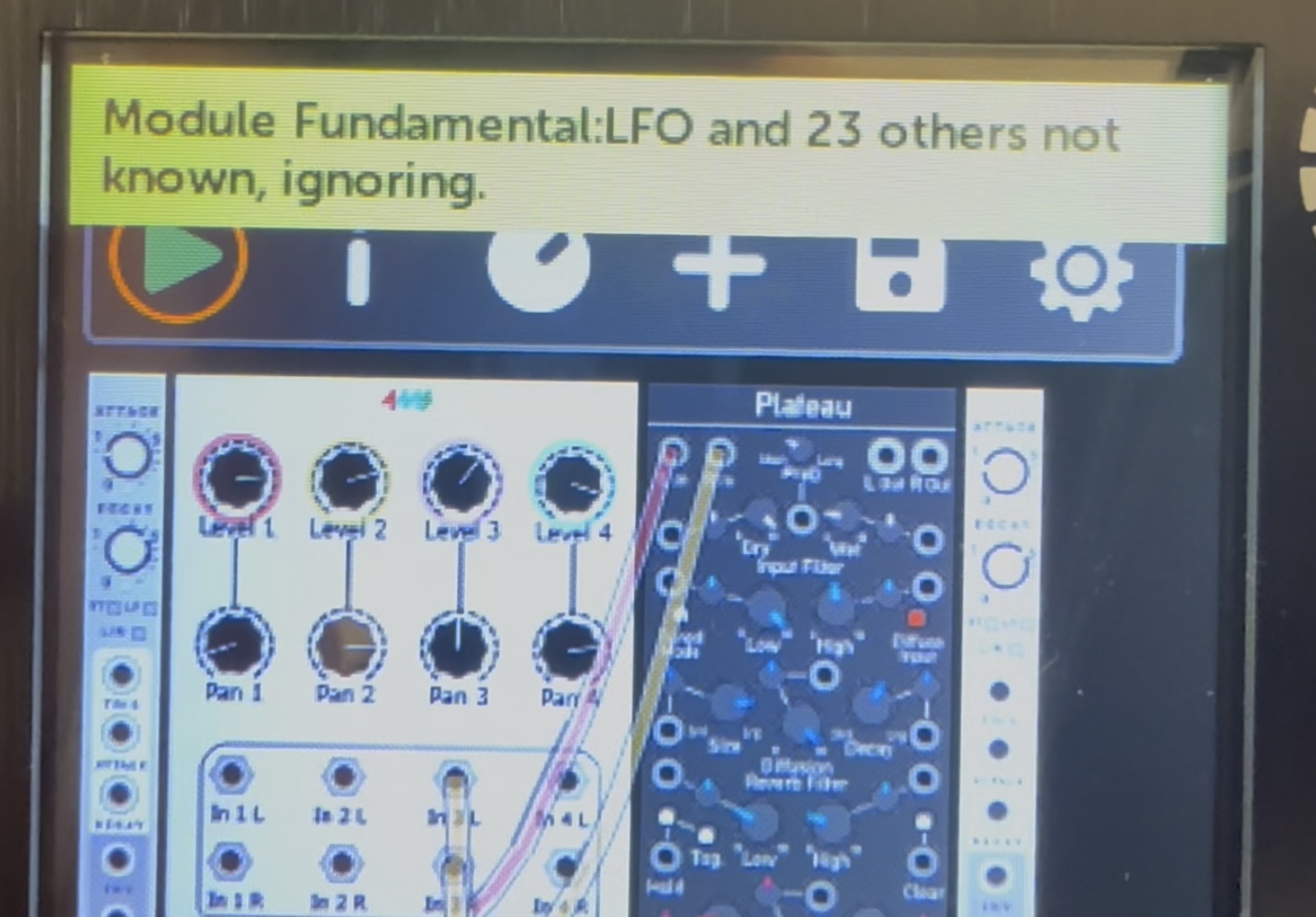

third error message when i try to load the ambient gen patch from the gallery.

im curious, have you updated to the latest firmware?
running v2.1.1
@danngreen might know. i think i remember running into this error loading plugin/missing symbol issue in the past, on a different firm.
Sorry about that. The error regarding “Error loading plugin: Missing symbol…” is because we accidentally included an old dev version of the Sonus Modular plugin in the zip file last night. I just fixed it – try downloading the plugin zip file again (or, you can just replace the SonusModular mmplugin file on your SD Card/USB drive with this one: https://github.com/Ericxgao/metamodule-sonus-modular/releases/download/v2.0/SonusModular-v2.0.mmplugin)
The next error about the “patch load > 99%” is because that particular patch will only run at 24kHz. So, set the sample rate down to 24k and it should play.
I’m actually working on a feature now to automatically handle this situation by letting the preferred sample rate and block size be stored in the patch file, so it will automatically switch to the right settings when loading a patch file.
The third error about “Module … not known” is because those modules are in plugins that didn’t get loaded. Perhaps because the plugin loading was stopped when it hit the error on the Sonus plugin? Once you get all the plugins loaded, then this should work.
And this is also another feature on the table, to have a pop-up asking if you want to automatically search and load missing plugins.
This would be huge help for switching between patches. Looking forward to this fix.
both very nice additions!
